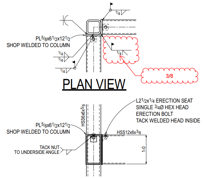

Can anyone suggest a good design example for a T connection at the end of a HSS (chord, or column)? similar to the attached. I'm doing up an SMath program to accommodate it.

Field or shop connection?
Magnitude of loads?
Likely field connections (welded) with temporary bolts. The magnitude is likely in the order of about half the section capacity. Even for straightforward HSS design, I generally don't utilise the section more than about 70%, else connections get pretty messy. The info is for writing a program to check the sums.
Sorry for the repeated follow-ups. What's the plan for holding the beam in place during erection? Can Pf and Mf reverse directions?
Possibly a little clip bearing angle. As a program, I'll accommodate all direction of forces.
I'm not aware of any examples addressing this specific scenario.
I think its safe to say that without a cap plate, your moment capacity would be somewhat reduced compared to if it was in the middle of the column. With a cap plate as shown (that is sufficiently attached to the top of the column) I would guess that it would be the same as or even somewhat conservatives to treat it as if it were in the middle of the column.
Thanks dauwerda... my thoughts, too. I was just hoping that I could formulate the strength. I've already done a regular T connection and wanted to extend it. CIDECT DG 3 is excellent, BTW.

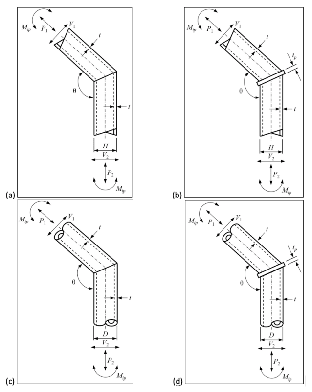

IMO that T joint could be designed better. It is difficult to get the required fillet welds in the areas nominated due to the radius of the HSS. The way I do these joints is as a mitred joint with aa plate in the middle. There is research showing the performance of these joints being superior to alternatives. Also suitable fillet weld size can be achieved much more easily than butt welded mitres or a T with fillets.
Thanks human... I have information for mitred corners and reinforced mitred corners... I was looking for something that does 'a beam and column' type of connection.

I typically work for the fabricator and I think dik does also. We need to provide a connection that won't be a pain to deal with.
dik:
I have never seen an example for this. I have run into it a few times but don't have an example that's anywhere near clean enough to share. Some thoughts follow. Hopefully they'll be helpful.
Assume the beam axial load is shared by all four walls on the basis of their areas. Assume the shear goes through the two vertical walls and the moment is resisted by a force couple between the top and bottom walls.
I typically make the cap plate wider than the column so it can be connected with fillet welds. The cap plate is usually overly thick to allow sufficient shelf dimension for the top wall-to-cap plate fillet weld.
Most of the checks are pretty vanilla, so I won't list them and bore you to death. Every time I've seen this, one of two things controls:
Column wall out-of-plane bending, aka plastification. I check this with the AISC Manual (15th ed.) Figure 9-5(a) and Eq. 9-30. Sometimes this controls by quite a bit, leading to through-plates like shown in DG24 Figure 4-4.
Weld strength at the beam bottom wall. Effective weld length from the AISC Spec. Eq. K1-1. That's a pretty short length sometimes, so it's often hard to make fillet welds work. Might need a CJP with backing instead -- then check the beam bottom wall for tensile yielding on that little effective length.

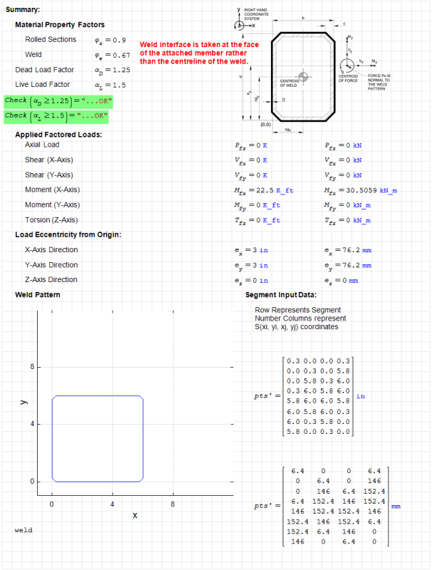

Thanks 271... that was the approach I was going to follow... but was going to include the 'webs' in the flexural calcs (I have an SMath program written for weld stresses). Only concern was the wall plastification and the weld stress distribution across the face HSS width. I've almost exhausted myself looking for a good example... maybe there are not any. Will do it the 'long way'. Thanks everyone.
Take a gander at the CIDECT DG 3, 2nd Edition... it's excellent.
SMath output, but for a different problem...
We use end plates pretty frequently to circumvent the tiny workable flats on some of the thicker-walled HSS sections and provide a substantial flare bevel weld to the column. I thought this erection seat inside the HSS section was pretty clever, but this was for a relatively lightly-loaded stair tower moment connection.
Erection seat and temp bolt is great... borrowed... thanks.
