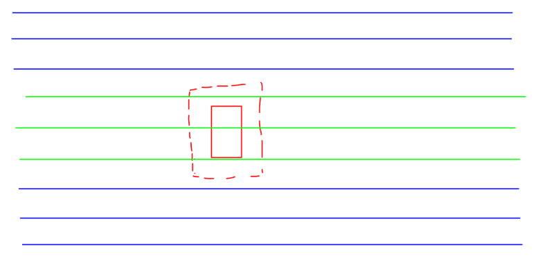

How come the PT doesn't "help" with punching shear?
Because most of the tendons are located far enough from the columns that the vertical load that they deposit at the support still needs to make its way over to the column via the punching shear mechanism. Consider the sketch below which depicts a tendon band running over a column and its assumed punching shear perimeter (dashed). The green tendons would reduce punching shear but the blue tendons would not.

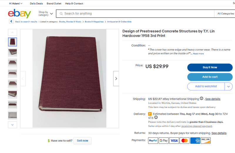

I guess only one person on ebay knows the actual cost of pizza because those prices were high [ponder]. I am probably going to talk to the older folks I know who are about to retire. I got me a whole box of books for just 6 beers the last time, best trade ever!

Is this not pretty close to pizza money? The shipping is only high because it would be to me, in Canada.
Surely this is cheap enough that, if you actually care to have this fine, historically significant tome, that is within your reach.
