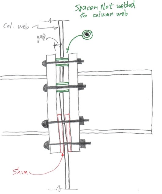

I wanted to know if this is an acceptable detail, for a beam to extend past a column, after which it acts as a cantilever.
Connection is through the web with thick plates.
Intention is for the moment passes through the beam only ... but the web will deform as well.
Is this an acceptable method and is there any literature on this?
Also how would you apply restraints so that moment is not induced in the column at this location?

Probably somewhere. But it is an uncomplicated connection and checks for such moment connection apply. Expect shear to be transferred to the column.
That depends on the degree of rotation and the relative stiffness's of the beam and column. To avoid this use big beams. Based on the presume relative scale in your drawing and presuming the back span isn't excessive very little moment will be transferred to the column. And vaguely modern structural framing software should be able to provide you with the amount of moment transferred.
Short answer is you don't. Long answer, if you are creative with cutouts and spacing shims you could achieve this but that is likely to be a crazy amount of work for little to no benefit.

Agree on the logic of using relative beam/column stiffness. The issue that I have though is that the column is working hard with all other loads, and even though the beam is stiffer, there is still some moment transferred to the column.
With attachment to the web, was aiming to somehow reduce the moment at the column even further, by modifying restraints.
Is this existing or a new design. If it is a new design the I'd just upsize the beam/column and make it work.

What do you mean by this? You mean making changes in your model to get the answer you are after? Yeah you can do that. But you will need to dig deep to ensure you are not being unconservative.
What you might be implying but not saying explicitly, is that because the attachment is through the web of the column the web will deform and not the entire column including flange. This would likely be true if the plates have a 'significant' space between the end of the plate and the radius of the web. Thus you will get less moment transfer than what is represented by your calculations or structural framing software. But again, suitably quantifying this in and applying it in a conservative fashion would be quite a challenge.
I'd either upsize the members or strengthen the members as appropriate.
For what it is worth the I've done something similar before with a heavy load being applied eccentrically to a support beam. (Multiple parties in a project meant that their heavy 20m gantry landed significantly eccentric to MY beam that was provided and already errected) I provided a bolt through moment connection similar to picture with a back span. The beam took the shear load and the back span took the moment induced by the eccentricity.

Extend the bolted end plates downward, and add some gussets on both sides of the beam.

In my experience colleagues and I have typically ignored the moment that would transfer to the column in such a situation. This seems like one of those self-limiting rotation types of problems.
If you think the weak-axis moment in the column is critical, you could build a shell model of the column and beam and see how much moment ends up in the column. The column web out-of-plane bending stiffness seems small compared to the beam flexural stiffness, so my guess is little moment would go into the column.
If you really don't want to have significant moment transferring to the column, you could try something like:

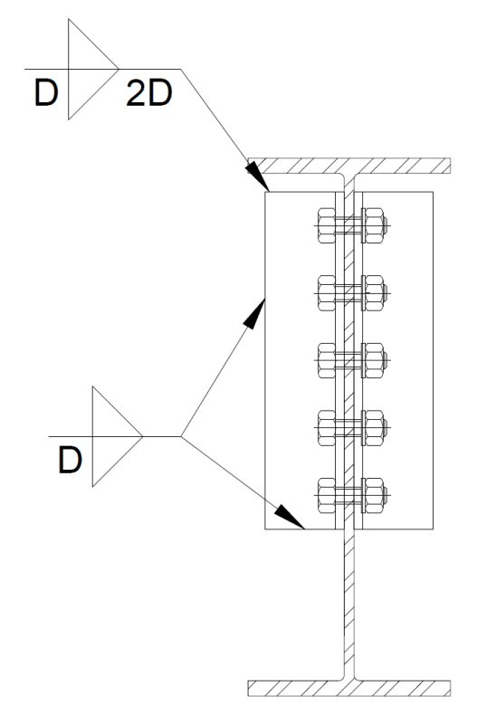

The only time I use that type of connection is to transfer moments. I may have a couple of these a week. I usually use clip angles, if no moment. See the next reply.
This is what I do... a common connection.
I think we're typing about different purposes.
The double angle is intended to transfer insignificant beam end moment to the column or beam on the other side of the column, right?
The connection I sketched is intended to transfer insignificant moment to the column but transfer lots of moment to the beam on the other side of the column. I've never had to resort to this connection, thankfully. LOL
You said that if you had insignificant moment... the connection shown may be more common... I misunderstood your connection. I don't think I would ever try to avoid transfer of a moment to a column with a beam on the opposite side... I'd simply transfer the moment through the column. If you really want to do that, use a flexible connection at the beam on the opposite side of the cantilever. You also have to be careful with shear transfer.

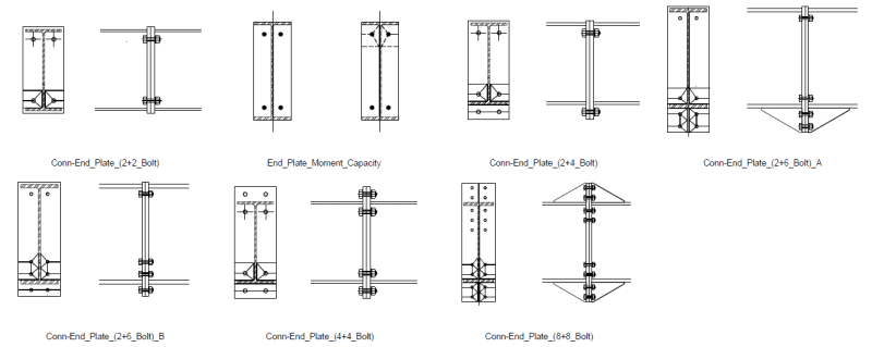

These are the connection types for stiffened end plate connections I've written SMath programs for. I have about 30 connection types and I add them to a *.pdf conn file that's on the desktop to I can pick the right program (This is a snapshot of part of the conn file) I have over 800 SMath programs for design so it's sometimes a chore in finding them).
