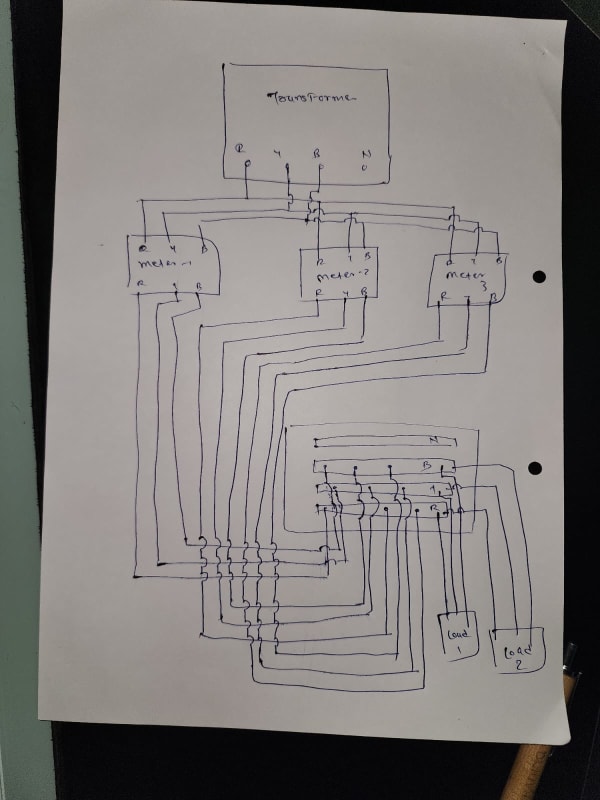

Hi
I have following system installed
Govt supplied transformer is incoming supply
From transformer - there are 3 energy meters installed. I have laid 3 cables 3.5 core 150 sq mm aluminum cable (length around 5 meter each) and all of them are connected to one Busbar chamber from there load is distributed
Now when I check current, following is my readings
Cable 1 - 103/133/160
Cable 2 - 144/135/104
Cable 3 - 125/103/120
Main issue is due to this, my maximum demand is crossing assigned limit and i am getting one meter reading higher than other 2
How to solve this and make even distribution ?

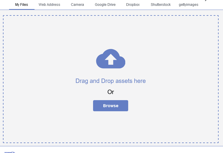

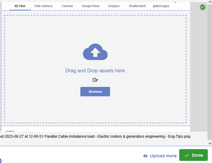

Tec-Tip: Use the IMAGE feature of this site.
You must first get a file containing an image onto your computer. Control-Shift-S will allow you to take a screen shot and save it to your computer, usually in the download folder.
Screenshot_2023-08-27_at_11-51-56_Parallel_Cable_imbalance_load_-_Electric_motors_generators_engineering_-_Eng-Tips_eyoplj.png
Click on the Image Icon and then click on Browse. That will take you to your download folder and the most recent screen shot will be at the top of the list. If the file is already on your computer rather than a screen shot, you may navigate through your file folders until you locate the file.
Click on the file of the image that you want.
Click on "Open"
Wait...........
When the file has completed uploading, the "Done" box at the lower right will become active and will change colour.
Click done.
You may click "Preview at any time to see how your post or partial post will look when posted.

David's comment on the cable length was my first thought as well. For cables in parallel, short cables are more of a problem than longer ones for unequal current division. Any difference in length is a bigger percentage difference in the total cable impedance, so this causes more imbalance. For long runs, the length difference is generally a smaller percentage of the total length. Also, physical arrangement can change the inductive reactance of the cables even when they are the same length.
Image attached - sorry for bad drawing
@warros
1)Its textile manufacture plant - load is heaters/motor/motor with vfd
2)Cables are going to bus and then load is connected thorough common bus - this was done to maintain equal load to all 3 meters
Why I want to change cables ? - Because length may have slight variation so as make of the cable. I want to replace and lay exact same length and same make cable so that cable property is match
Power factor issue is not there as I have already installed automatic power factor correction panel and its maintaining PF near 0.99
And its not that one cable is taking high and other is low. Its phase vise unbalance
Cable 1 - 103/133/160 - Here R has low and B has high
Cable 2 - 144/135/104 - Here R has high and B has low
Cable 3 - 125/103/120 - Here Y have low current
Regards,
Devesh
I need balance current just because one meter goes to overdemand and will attract penalty
Sum of currents in each phase is almost same at around 370 to 380 A. How that would raise your input demand? The metering CT measures all currents at one point at the point of supply.

Is there a way to reduce this unbalance ?
If I separate out each conductor from cable and group them phase by phase, will it change something or will make things worse ?
There is an important question that has not been answered.
What are your individual phase voltages.
No amount of cable changing will correct a voltage unbalance.
IF the problem is cable impedances (due to the arrangement of the conductors) then grouping phases may make things worse.
possible mitigation measures:
IF the problem is cable impedances, replace with three core (plus ground) cables. IF the problem is cable impedances from the transformer to the meters and three equal three core cables from the meters to the load bus.
Alternately, three equal cables from the transformer to the load bus and cut in the meters at any point.
But, things to check;
These checks will be affected by voltage unbalance do check voltage first.
Check the current balance of each load. If all loads are running high on the same phase, that is another good indication of voltage unbalance.
If then voltage is good, and some loads have one phase current high, roll the connections (A-B, B-C, C-A) so that the highest phase current is on another phase.
Thinking outside the box, you may try increasing the impedance of the high current conductors.

".... Govt supplied transformer is incoming supply to .... 3 energy meters installed. I have laid 3 cables 3.5 core 150 sq mm aluminum cable (length around 5 meter each) and all of them are connected to one Busbar chamber from there load is distributed ....... following is my readings Cable 1 - 103/133/160, Cable 2 - 144/135/104,Cable 3 - 125/103/120 ...."
1. there are numerous learned advice posted. I wish to add the following for your consideration.
2. Visually check that the three cables from the Trafo to the meters are Cable 1 is [1L1, 1L2, 1L3] and Cable 2 is [2L1, 2L2, 2L3] ..... in trifold form. NOT, [1L1+2L1+3L1], [1L2+2L2+3L2] .....
3. Check cable from meter to busbar. Cable 1 comprising of [1L1+1L2+1L3+1N], Cable 2 comprising of [2L1+2L2+2L3+2N}...... Each cable comprising of [[L1,L2,L3,N] throughout the whole length.
4. As Al is used for cable lugs, cables and busbars, check the workmanship. Retighten every contact point to the "correct" torque!. Please furnish the bolt size and the torque used.
4.1 Observe whether any changes in the current, as compared to the initial readings.
4.2 Roll the phases and observe the current as compared to the initial readings.
5. In usual case, it is not required to change the cables, as the three cores+N are of equal length.
6 . However, the cables to meter 2 and 3 current may differ from that of meter 1, as they could be of sight difference in length. What we tried to achieve is L1, L2, L3 in a 3c cable is about equal.
Che Kuan Yau (Singapore)
Nope, all of the L1s have to be exactly the same length (same impedance) and all of the L2 have to be exactly the same length as well as all of the L3s. But there can be some variation between the L1s and the L2s and the L3s. The differences between phases will be determined entirely by the load, but the distribution of currents of any given phase is entirely driven by the difference in impedance between the paths.
Your demand is coming from your load, not from the unevenly loaded cables (whose sums in each phase are more or less equal anyways).
