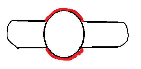

A couple of years ago, I did an analysis on a structure I was designing, and one of the things I checked was shearing of the flange under the washer. A slot significantly reduced the area of shear. I wound up removing slots from my design.

In a normal hole the bolt is supported under the entire bolthead. with a slotted hole this is not the case. You can check the shear force under the bolthead with the red area in picture below as an indication how strong the slotted hole may be:

Well there are in fact problems. Without suitable washers (eg suitably sized and thick plate washers) then you have a loss of tensile capacity and rigidity.

Sections 6.1.2 and 6.2.6 of RCSC's 2020 Specification for Structural Joints Using High-Strength Bolts require you to use washers that completely cover the hole whenever oversized or slotted holes are used, so you would still get bearing in tension the entire way around the hole.
Local stresses in the area around the bolt holes due to tension is not a typical check for steel connections, but I would suspect that the larger perimeter you get from the washers would increase the tensile capacity to be comparable to a bolt without a washer in a standard hole.
