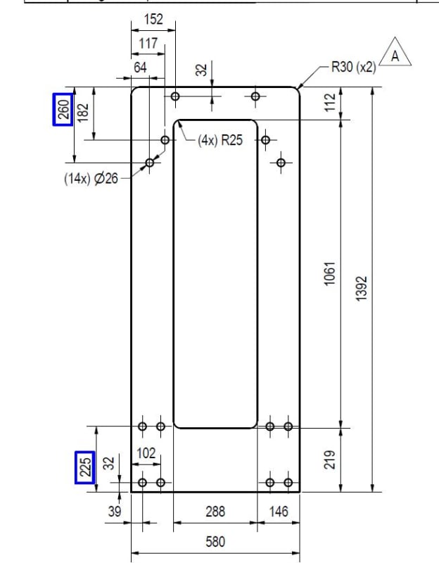

Hello, I need to provide a design to field weld a splice connection between 2 box truss beams that have plated ends. We normally bolt them together, however, the plate hole patterns aren't aligning. I'd like to weld the plates together and was hoping for some feedback on my plan. Any feedback would be greatly appreciated!
geometry:
- box truss beam with plated ends. the beam is split into 3 equal parts with splices at 1/3rds.
loading:
- vertical cyclical loading with a known dead weight
- horizontal wind load per ASEC7
- normal loading conditions with the bottom of the beam in tension and top in compression. +/- for the wind plane.
plan:
I'd like to specify SMAW with AWS D1.1-2020 detail BC-P2 since T1 allows unlimited depth. however, I don't think I really have a butt weld here, but I can't find a good match for welding edges of plates together. can I consider this a large butt weld and use detail B-P3?
issues:
- D1.1 4.18.1 one-sided groove welds is prohibited for cyclical loading
I'm wondering if anyone knows a better prequalified weld detail to use if I plan to add weld to portions of all sides of my plate connection?
Thanks for taking a look!
Mitch

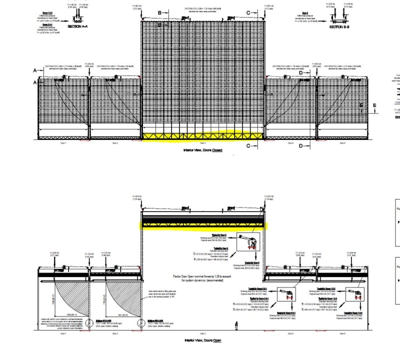

I'll explain more about what we're trying to do. This is a door system and we are having issues with the center door; it's similar to a Venetian blind where you have a bottom beam that gets loaded up with the door package as it opens (hence the cyclical dead weight loading part). It also resists a portion of the wind load when the door is closed. here is the door in the open and closed position with the beam highlighted.
I want to add weld to the splice connections to keep the job running. We're not setup to replace plates in the field due to the tolerance requirements for the door system.

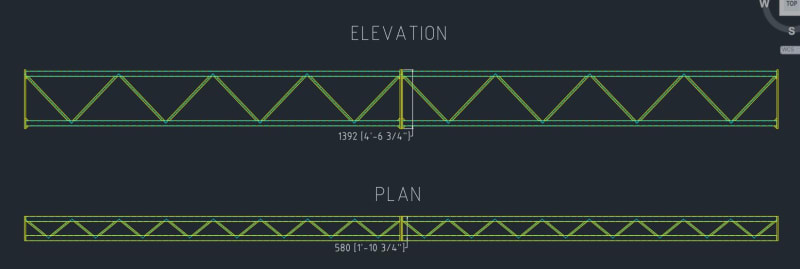

here's the beam in elevation and plan with some dims of the splice

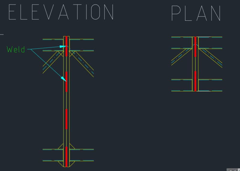

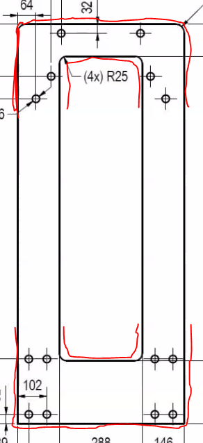

my plan is to add weld to all four sides of the splice something like this:

Top chord - likely no problem. Cyclic but no load reversal, right?
Your tension-side plate bending is going to control. You can't just CJP weld around the edges. The thing would pry apart.
If you give us more of the geometry we might have more precise advice.

That tension side is what I'm really concerned about. wouldn't these be PJP on the edges? also, it would be a lot of work, but If I had them weld continuously all around the exterior and the interior edges of cored out section, would it be considered a built-up shape?
Those splice plates are A572 grade 50, 32mm thick
here's the flat file for the splice plate

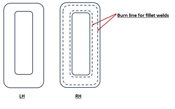

If you could weld the inside and outside, something like the following I might be able to get on board with it:
How misaligned are the holes? Can you just oversize the holes and fasteners?
It looks like there might be enough plate to burn 12mm all the way around one side and then get a fillet weld - could burn 12mm off of inside and outside

dauwerda, this is really what I'm looking to do. I would specify a PJP groove weld on both sides to limit the plate from buckling and stressing the weld root.
SWComposites, that was the first fix I looked at. The issue with drilling out the holes is that I'll end up with vertical slots. The only fix I can see working is to weld the plates together (other than getting it back to the factory and putting the correct plates on it so we can bolt)
dvd, unfortunately, we have the chords coming in at the edges of the plate. so, we wouldn't be able to burn the edges. I think the only welding option would be to use a PJP groove
