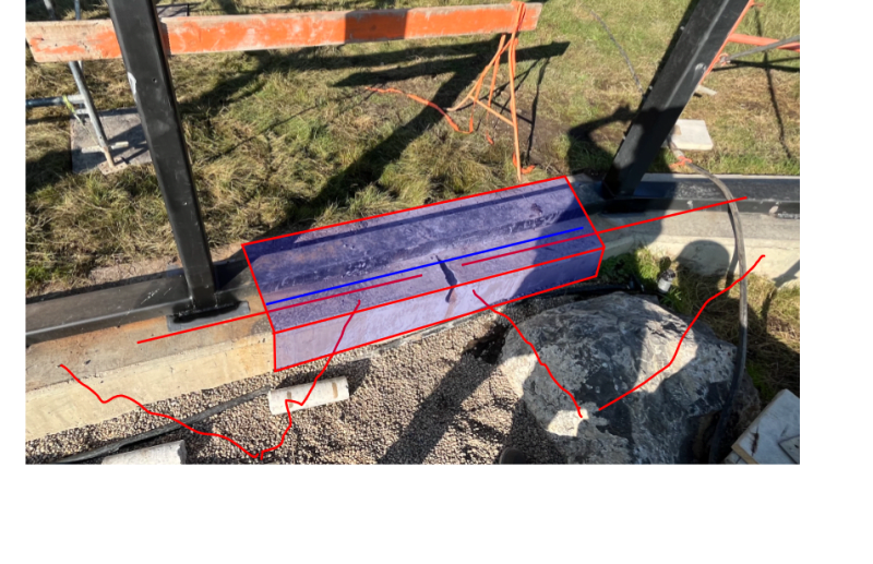

- Grade beam on a local infrastructure project. It supports a fence that keeps sabre toothed tigers from eating babies. Low importance factor as with most livestock stuff.

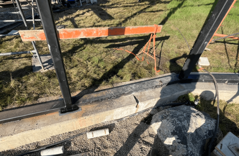

- An unfortunate core has been made through the grade beam top reinforcing.
- Various constraints are making it desirable to get this repair done in as localized a manner a possible. The fence is already in place and its anchorages are nearby to the location where this repair will take place. The repair location is also very close to a plan "corner" where the grade beam changes direction over the pile.
- Quality control on this project is good. You know, other than this ridiculous core.
- One repair option being considered is field welded splices of the reinforcement. This is not weldable rebar, however, so we'd have to deal with preheat.
Questions
How good -- or bad -- of an idea is it to consider field welded reinforcement splices here from a QC perspective?
Is there any danger that the preheated bars would expand and cause the cover concrete of the grade beam to spall?

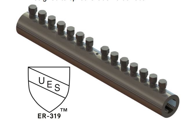

Why not a bar lock coupler (See attached image and tech sheet)???
How far back are you going to remove/chip away the concrete to make the repair? 1" away from weld (and preheat area) I could see it possibly (probably?) being an issue. 1ft away from weld, probably much less of an issue. If you go far enough that you have sufficient room to wrap the rebar in water soaked rags between the weld and concrete that would give you even more protection.

I'd certainly entertain / prefer bar couplers, as would the contractor I'm sure. I do have some concerns however:

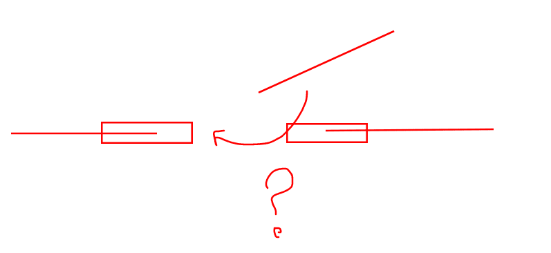

1) Because this is a bar gap rather than a bar splice, per se, will I not need two couplers in close proximity for each "spliced" bar?
2) If each bar splice requires two couplers, how much of a gap between bars do I need to create in order to feed the middle piece in there somehow?
3) We would not be able to maintain specified cover to the mechanical splices. Is that something that ca be relaxed locally?
KootK,
My guess/intuition tells me:
1) yes
2) 1"
3) Galvanized couplers?
1) and 3) suggest to me cutting away more concrete each way to expose the required length of existing bar, adding a center splice bar with two couplers for each bar line, then replacing the lost concrete around the bars and perhaps adding concrete above? (don't know if that is possible with your situation).
Thanks for that. I was just about to summon you to this thread.
Tentative chip dimensions are shown in the sketch that I posted originally. There's space for more, just not a ton more. Corner condition sits on a pile with a rather important torsion connection to the beam. I'd not be to excited to have to mess with that.

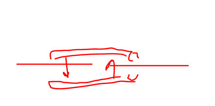

JAE said:
That can't be right. I must have explained my question poorly. Try the sketch below.

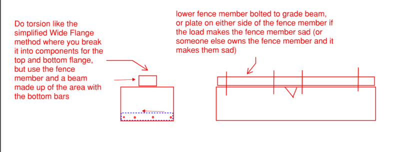

Is it just top bars?
Can you just say screw it with regards to the rebar, grout it all closed and then bolt some plates to the top or side?
Alternately, is that bottom fence member an HSS rectangle? Is it honky enough that you can run some bolts through it a handful of times and use it to bridge the gap? That might be a bit aggressive if there's glazing and the resultant deflection issues, but you don't need to get the forces far, so it might still get you there.

What would be awesome is if there were a two piece mechanical coupler that could accommodate the gap. A lot to ask, I know.

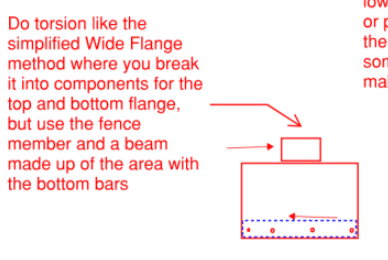

If the torsion loads are moderate, then there's potentially something like this. Likely isn't feasible because of the visibility issues if it's plates and/or issues with glazing in the fence if it's the fence member, but the math would be pretty easy.

Maybe the thing to do is just chip out between the posts and make do with whatever double lap that affords me. I don't supper love my anchorage frustums cutting through the repair but perhaps I just need to reconcile myself to that. I often tell other folks here that's okay.

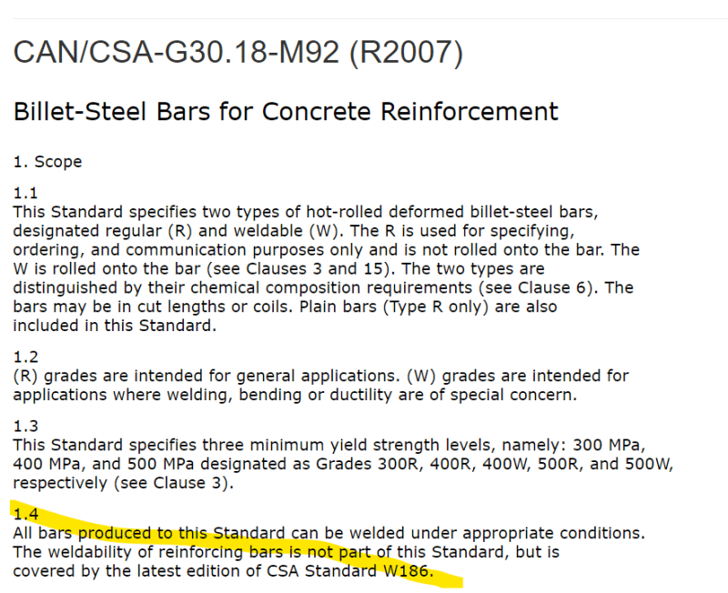

Take a close read of W186. The scope of G30.18 says that all bars are weldable given the right conditions.
The 2021 version is a little less fully supportive in its stance, but still just says that 400W is 'more suitable' for welding
edit: The field review photos might show the 400W tag rather than 400 or 400R, which would make life really easy. It's a low percentage chance, but it's free if it's there so if you can check reasonably easily then it's worth doing. If you can get the mill certs then you're already covered though.
You're solidly in the running for the polka dot jersey and the "most exotic solution" award.
My primary concern with that would be stiffness compatibility. I feel as though the grade beam would be in shambles by the time that you properly mobilized that HSS rail in warping torsion.
