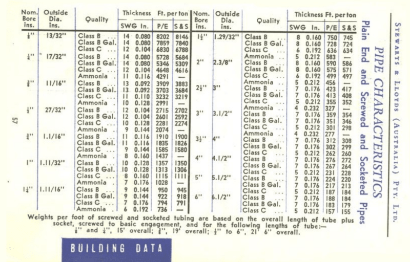

Does anyone have reference material for historic grades of steel tubing in Australia? I am looking at a project involving a truss structure built out of tubing, and all I have is the following information:
* OD and Thickness listed as what I believe is a gauge. E.g. "1 11/16" OD 9g"
* The drawing lists material as being grade 13 or grade 20. It's painted, so can't tell what it is for sure, but believe it's mild steel based on the rest of the site where I have seen similar tubes that have rusted.
* Drawings are dated March 1958.
* Designed by Moore Crane / Malcolm & Moore Industries, but some drawings also call up Stewarts & Lloyds of Newcastle NSW.
Does anyone know what the gauge means in terms of real thickness, and / or have information on what the material is?
I've checked Standards Australia's publication MP84, but the first Australian Standard that covers hollow sections dates to 1965, so it's not a structural grade. It could be a piping steel, or something American / British?
Thanks for any help.
Download the 18th edition (1950) edition of the infamous Lysaght Referee: Link
It references Stewarts & Lloyds - who were distributors.
Page 57 has the following (see lower left corner):
It tabulates 1-11/16" pipe, 9 gauge (class B) in both plain and galvanized. 9 gauge is 0.144" wall thickness.
SWG is Standard Wire Gauge, which I think is the same as British Wire Gauge (BWG).
Thanks for that Ingenuity - who knew Lysaght made anything other than roof sheeting? Looks like they used to sell anything and everything! Do you have any idea of the grade of steel? It didn't seem to be in that document. If worst comes to worst I can just go with AS4100's 170/300 rule.
On the meaning of SWG, the 1963 version of the Referee calls it Imperial Standard Wire Gauge, and has a handy-dandy conversion chart showing how it compares to 5 other gauge systems. It is not the same as BWG though.

The other question should be what the minimum wall thickness is.
I take the table as 0.144" nominal wall.
If this is tube then I would expect +/-10%, if it is pipe it would likely be +/-12.5%
Since they call this 1.25" ID it sounds like pipe.
