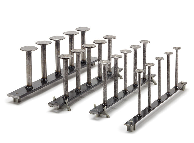

I know ACI 318 has guidelines on stud rails for flat slabs for shear reinforcement (at columns).
We often work with one way joist slabs. Joists are 2ft o/c, 4.5" wide and 10" deep. These joists often need shear reinforcement (1st and last third of the 25ft span - roughly speaking).
#3 Stirrups are a pain to put in. O-stirrups are impossible - no room.
Could I not use stud-rails? I looked at the costs and they are not that bad.
Any insight you may have would be much appreciated.
I don't see why you couldn't do that. And it's a clever idea.
My only concern would be that the studs may have to be stacked with stud heads occurring part way up the joists. I believe that negatively affects performance so, whatever one normally does to address that in slabs, I'd think that you'd want to do the same thing here. Do fact check me on this, however, as it's been a good long time since I've contemplated stacked studs.

Hence the Stud Rails - can be ordered in any height and spacing is a variable. The bottom rail comes with its own chair...
