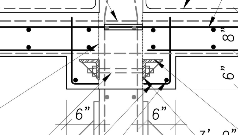

3 - I live in a CIP world so I would go CIP. But presumably pre-cast would be lighter so may be advantageous in keeping loads similar to what they were originally. In situations where we replace concrete slabs either side of a shearwall we will often through-bolt an angle either side and weld the bottom slab reinforcing steel to the angle. This provides continuity across the joint that acts somewhat like integrity steel. You can also just through-epoxy bars to do the same.

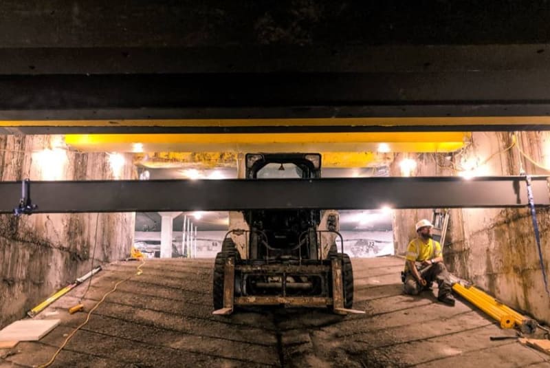

4 - How heavy are the slabs? You may be able to beam and lift from above. I've done that for a number of interior slabs and such items. Don't have a good picture of a slab lift sadly but here's one below of us lifting some beams under an underground parking garage ramp to give the idea (admittedly way lighter). Or if you can fit an interior forklift that may do the trick. Either way I feel a beam/composite slab configuration also works.

3- I like the through bolting idea, but I think I'll keep the slabs as simply supported for each balcony, this way the slab can simply bear on the angle each side.
4- I think the geometry and presence of partition and infill walls wouldn't allow for the erection, I'll try to solicit opinions from contractors though. They tend to be more creative than me when it comes to erection procedures.
