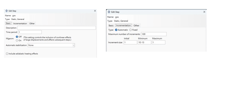

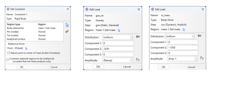

Thank you for your reply. The model I want to build is a single-mass car. The mass block is connected to a negligible wheel by a spring, so the density of the wheel is set to 0.

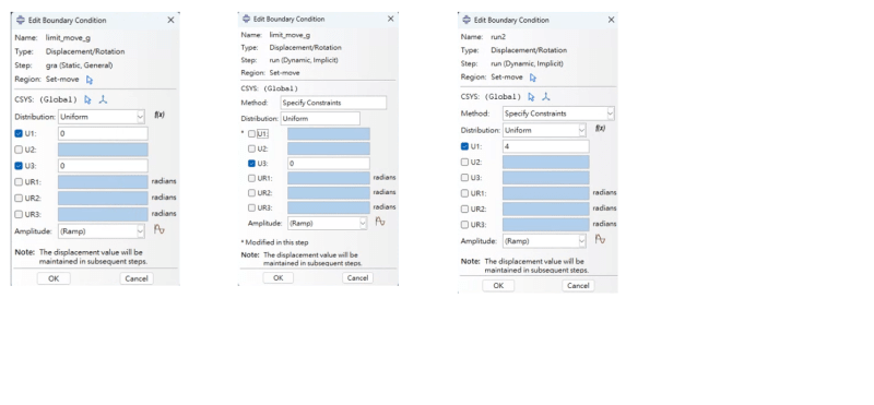

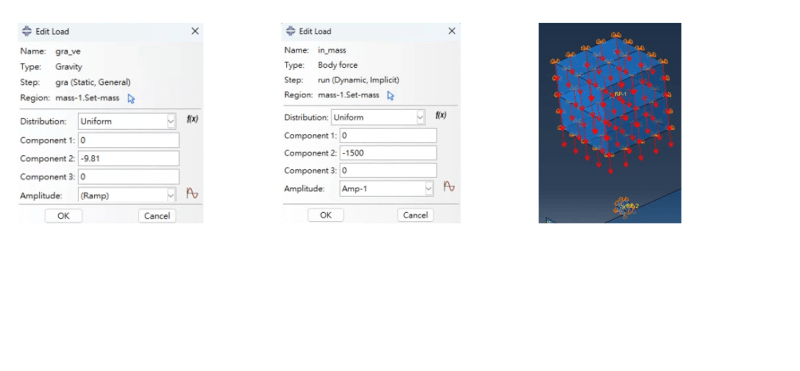

When I assume that the car body and wheels are rigid bodies, when I set the movement conditions of the vehicle, are they imposed on the reference point of the rigid body?
Better use very low but not zero density. And apply boundary conditions directly to the reference point. Usually, Abaqus can transfer them automatically to the ref point but it's better to avoid this since it may not work properly in some cases.
Will setting the boundary conditions directly at the reference point create excessive constraints?
According to your suggestion, I should change the loading gravity, inertial force, and displacement conditions to the reference point. Will it be beneficial to the analysis?
Check the documentation chapter Abaqus Introduction & Spatial Modeling --> Spatial Modeling --> Rigid Body Definition, paragraphs Kinematics of a Rigid Body --> Boundary Conditions and Defining Loads on Rigid Bodies. There it's all explained.

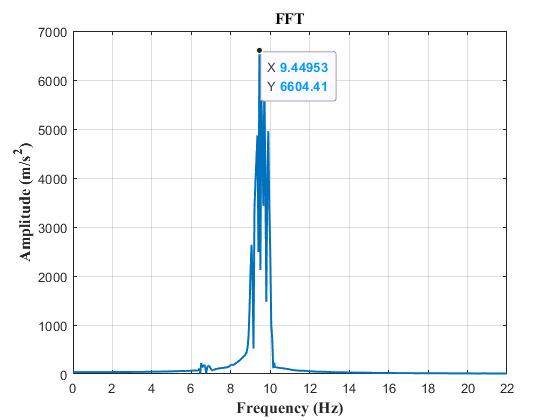

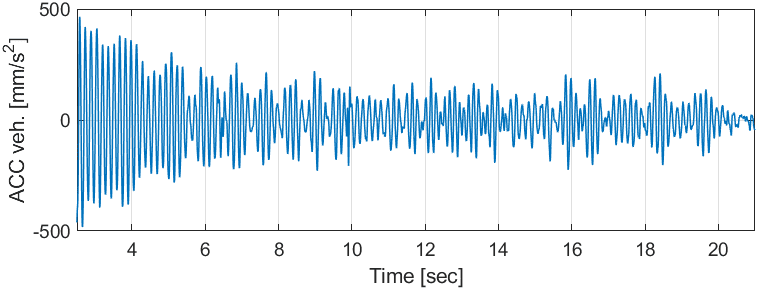

I now use fft to convert the acceleration of the car body into frequency. There is only the frequency of the car, not the frequency of the bridge. How can I correct my model?

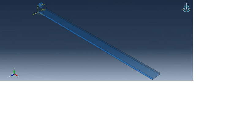

My vehicle currently moves from the left to the right of the bridge using hard contact and frictionless force. Do I need to correct the interaction?

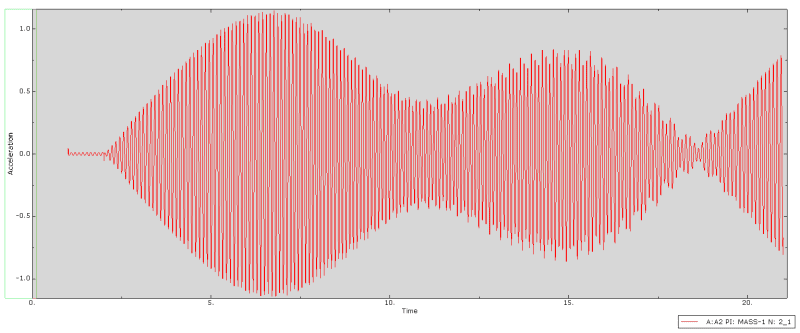

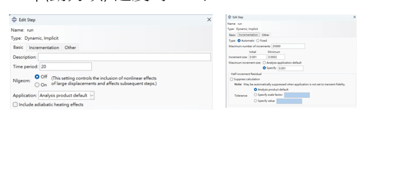

I would like to ask, the red line is the acceleration of the center of mass of the car body. How can I modify it to be the same as the blue line, so that there is an acceleration response from the beginning?
I would also like to ask what is the difference between field output and history output? What if they both take the acceleration of the same point?
