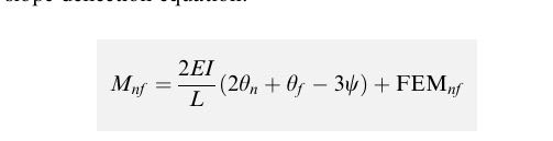

on a quick cursory review it looks like you are missing the psi components of the joints to account for the fact that this frame can experience sway:

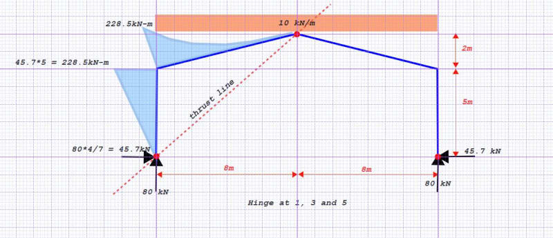

Let's assume the frame is a three hinged arch...hinge at 1,3 and 5 (big red dot). The structure is statically determinate and it is easy to calculate the moment at 2 to be 228.5 (I took the load to be gravity load, not sloping as shown on the OP sketch).
The so called "hand" calculation provided is not easily understood, at least not by me. The slope deflection method would not be my choice, but it is a perfectly sound method. Since the structure and the loading are symmetrical, consider half the structure (from point 1 to 3). Rotation is zero at points 1 and 3. Horizontal deflection is zero at point 3.
Calculate rotation and deflection at point 3 with only the fixed moment at point 1. Apply horizontal force H and moment M at point 3, then solve to bring theta 3 and delta 3 to zero.

I think Celt83 pointed out the problem. I was not including the psi terms from the slope deflection equations. I have only ever analysed structures where psi is zero. I had a look into it yesterday, but I think I might as well stick to using the direct stiffness method, as its quite complicated to find psi for this particular structure.
A three hinged arch is more flexible than a rigid gable frame, but the deflections are not "massive". Not many engineers would consider the columns fixed at the base. They are not hinged either, so perhaps a rotational spring would be ideal.
For purposes of a homework assignment, a fixed end can be assumed. I would agree that the stiffness method is best in a work environment, preferably with the aid of a computer. To perform a true hand calculation for this frame is onerous and likely to result in arithmetic errors.
