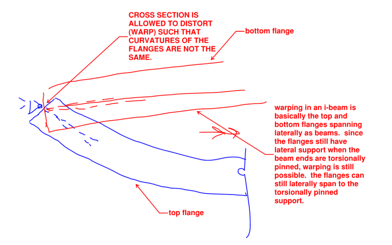

jochav5282 said:
That design guide says that warping stresses can't develop when the section is not restrained from warping, as would be the case when it's "torsionally-pinned".
This mostly comes down to the somewhat confusing meaning of "torsionally pinned". It does not mean that the beam ends are free to rotate. Rather, it just means that warping is not restrained at the beam ends (the cross section is allowed to distort such that lateral bending stresses develop in the various parts of the cross section.
The sketch below shows how a torsionally pinned beam still resists twist via warping. It's a view of a wide flange section from the top. Simple span with twist restraint at each end.

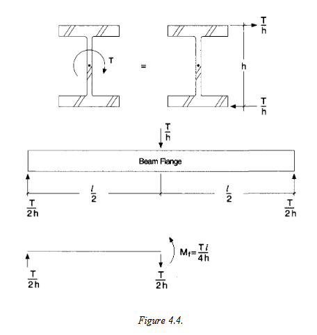

Hmmm, this seems almost self evident to me.... It' for the same reason a simply supported beam with no moment restraint at the ends can develop moment at mid span.
If it helps to understand warping stresses thing of them using the WT analogy. If I at a point torque at midspan of a torsionally pinned beam. The torque could be replaced by equal and opposite point loads applied to the two flanges of the WF beam.
The warping stresses are like the flexural stresses that develop in those flanges...

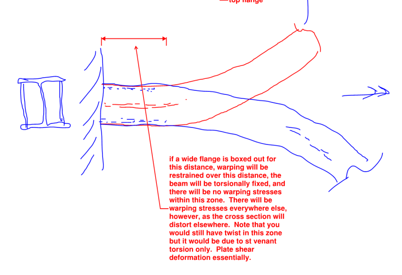

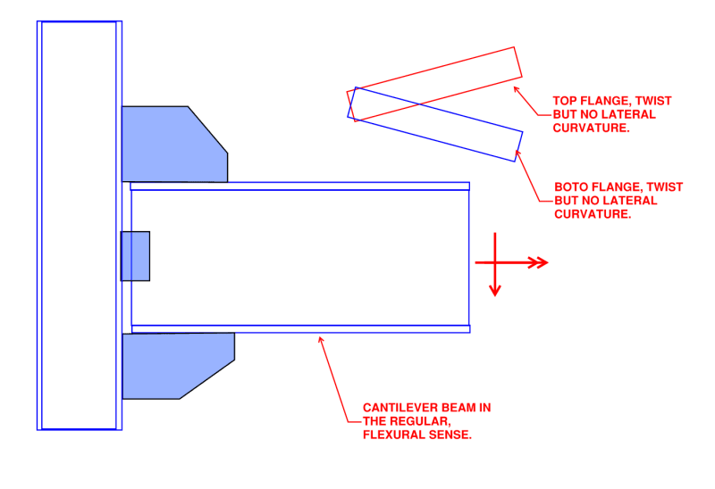

Torsional fixity in comparison to my previous post.
This is the closest think I can think of to a practical situation wherein one would have no warping torsion restraint anywhere within a beam span. And it's not very practical.
