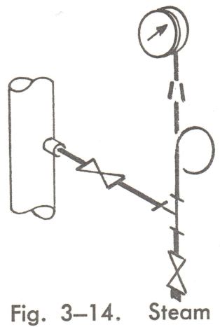

Like this? Pretty common for steam applications.
It'll be mostly line pressure. A 1.5m "pig-tail" steam siphon is likely around 0.75m high. Perhaps half of that height is in the riser from the header, so you'll have, at most, approximately 0.25-0.4m or so of head loss from the condensate during operation. Since there is usually air in the siphon before startup, the actual measurement error will be the differential head of the condensate in the loop. This is minimized because air will be compressed on the gauge-side of the condensate, limiting upward rise due to the steam pressure.
All in all, you're probably looking at 1-2 kPA error, at most.

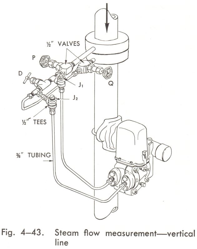

If it's a smart transmitter with process heads with the port on the side, you can mount like the one shown below, but with only one impulse line running to the pressure port. The tee at J1/J2 is used to fill the impulse lines with water. A smart transmitter will have a parameter setting to subtract out the head pressure of the water in the impulse lines.
