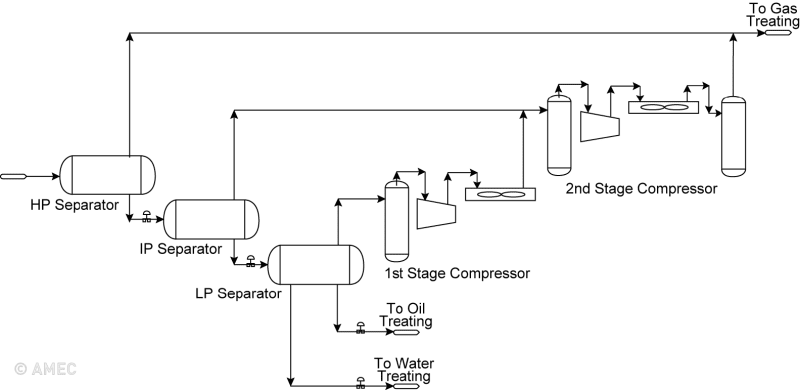

Appreciate suggestions regarding the below case.
The liquid outlet from the separator is saturated, that means any reduction in pressure will result in a slight evaporation of the liquid and the formation of gas bubbles. In the attached scenario, the level control valve induces pressure reduction, leading to the creation of gas bubbles, a phenomenon known as "flashing," which can adversely affect the control valve, potentially causing erosion and damaging it. In such cases, how can we prevent flashing, or what are the typical ways to handle this situation?

I very much doubt it, but you haven't given any pressures in the tank or downstream of the separator on the liquid side or static head here.
So lets say your static head from liquid level to control valve is 5m (pretty big). Your SG is 0.8
This gives you 0.4 bar to drop across your control valve before the liquid flashes as it exits.
That's not a lot.
Note that the pressure in the tank is irrelevant here as the liquid vapour pressure is the same as the gas pressure in the separator. All you have is head difference to prevent flashing.
You need to look at the whole system here, not one isolated little bit.
And specify the fluid conditions to the valve vendor.

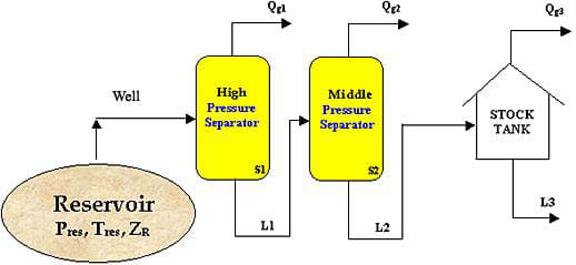

Without data, I cannot be sure, but I think you are trying to operate at too high of a pressure and you may need to reduce the operating pressure of this vessel (reduce the gas PCV backpressure setting) and try to get more off gas flow while reducing the liquids vapor pressure. Alternately, you might benefit from changing this setup into using two, both a high and low pressure seperators. That will reduce the pressure drop across the level control valve of each vessel. NEED PRESSURE INFO to understand if that is a reasonable thing to try.
