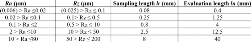

I have a chart that about cutoff length and evaluation length conversions, but the formula is simple, Evaluation length = 5X cutoff length.
In my practice the smaller the area, the smaller the cutoff value. Makes sense. However we still use the 1996 version and it's more friendly in the wording also, and I never stated a cutoff length value anywhere on my drawings. I'm just lazy and I let the gauge technicians evaluate my callouts.
Thank you very much, Wuzhee.
I see that this chart is based on the intended Ra and Rz values and provides the cutoff (sampling) length for roughness. Is there any chart or guidelines for waviness cutoffs as well?

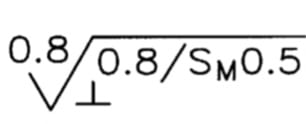

A follow up question,
In case of a waviness specification on the drawing - Wt, does the cutoff that needs to be stated inside the surface texture symbol represent the waviness short wavelength cutoff (=roughness long wavelength cutoff) or the waviness long wavelength cutoff (that attenuates the form deviations from the filtered profile)?
Until someone with better knowledge of surface texture requirements documentation and an up-to-date version of ASME Y14.36 steps in, here are my two cents:
I have the 1996 version of ASME Y14.36. The only mention of waviness is in Sub-paragraph "4.6 Waviness Height" and it specifies that you must place the Wt parameter to the right of the cutoff length, same as Sm is shown in fig. 5 (see below). Logically, if we replaced Sm in that symbol by Wt, the cutoff length of 0.8 would need to apply to both parameters as it currently applies to both Ra and Sm. As you already mentioned in your question, the long wavelength cutoff for roughness is the same value as the short wavelength cutoff for waviness. Which means that if this value is specified, it is useful for filtering of both profiles. So, in my opinion, the "waviness short wavelength cutoff (=roughness long wavelength cutoff)" is the value that you should place in the symbol. The caveat to that is, that this value is NOT the sampling length for waviness, as the sampling length is always equal to the long wavelength cutoff. So chances are that the inspector would still need to figure out the sampling length/long wavelength cutoff for Wt.
Again, anyone more informed is welcome to refute my conclusion.

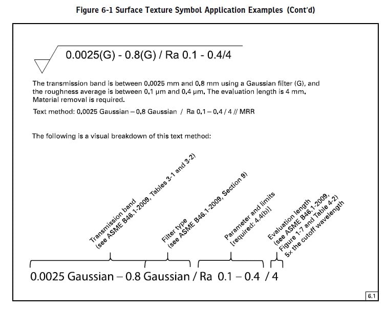

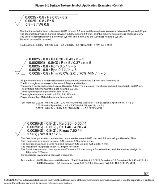

Maybe these help. (at least with standards that can actually help you). Taken from 2018 edition
Wuzhee, Thank you.
Are these figures from ASME Y14.36-2018?
The 1996 version doesn't cover specification of transmition bands. Did this change in 2018?
Yes.
But I think the 2018 version is way less user friendly and leaves the user with more questions than answers.
I'm obliged to use the 1996 (R2008) at my company and I'm happy to do it.
B46.1 is your standard, or contact a measurement company who has insights on these things.
