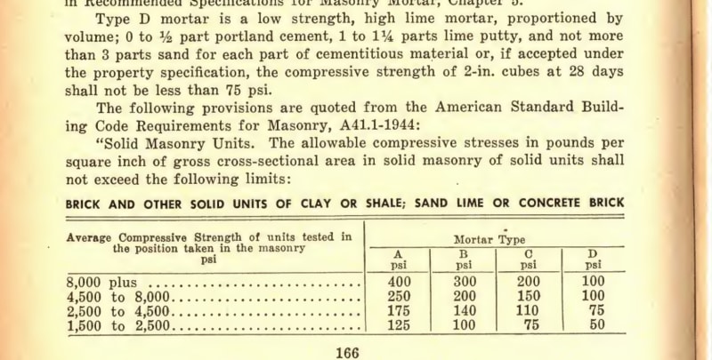

Brick and Tile Engineering by Plummer is a good reference for this time period. Link:
The compressive stresses listed range from 50 to 400 psi.
