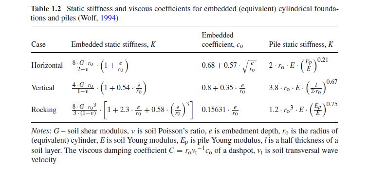

I am working on a wind turbine project which requires to compute both the Kdynamic and Kstatic.
There are several approaches for Kdynamic but I haven't found any for the static stiffness. Does anyone know a reference?. Thanks.
What is k? a spring?
In my experience, these problems are solved through soil structure interaction using FEM.
My suggestion would be , to look soil dynamics books to get the concept.
The following excerpt is copy and paste from Practical Soil Dynamics (by MILUTIN SRBULOV )
... the following static stiffness and viscous damping coefficients shown in Table 1.2. Static stiffness coefficient is the ratio between applied force and caused displacement and viscous damping coefficient is the ratio between applied force and caused velocity of movement.
