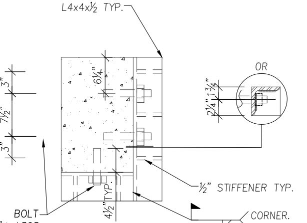

3. Chip off the cover (~25mm to 38mm) for a bearing seat, add angles to extend the shear face (with epoxied through-bolts), and add new bars overtop these angles

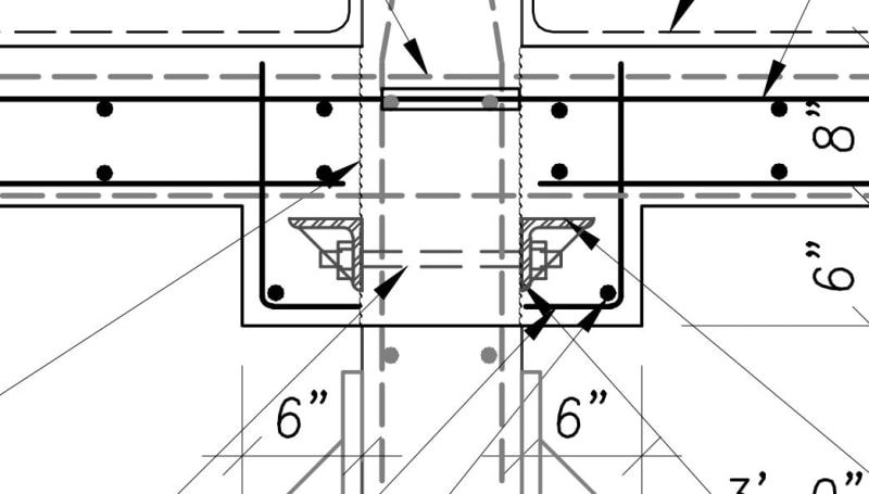

I prefer option (3). It's not really that costly and I routinely did this without issue when I was a restoration contractor. I even had a section in my intermediate slab replacement estimate sheet for this and it never amounted to anything significant. I actually found the through-bar grouting far more of a headache given the awkward size of shoehorning a bar in there and holding it in place during liquid grouting.
Below is a common detail for option (3). If you don't want to create the haunch then you can reverse the angle leg and keep it in the drop.

3) I like this approach. This is similar to what I have observed already installed from previous repairs but they have left the angle exposed and not cast in. Are you designing the shear to be completly taken by the bolts here? Also I could see issues with drilling at hitting column vertical steel and the contractor making swiss cheese of the column in an attempt to through bolt.

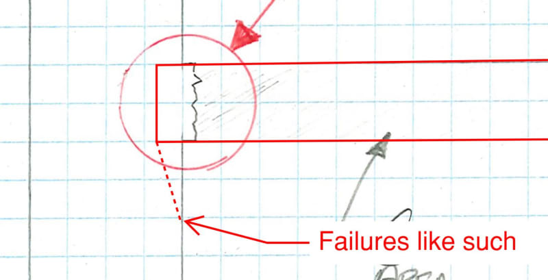

The 50mm "key" in the column seems to work, but my understanding of the concrete cover in columns is it is not typically relied upon for strength. Additionally, I see failure methods of the wedge below the bearing seat spalling of due to shear friction failures. The bearing calcs out but im not sure a simply bearing calc really covers all of this condition.
Someone correct me if I'm wrong, but that wedge is not a failure plane. I don't think this is a shear friction issue with the bearing seat. It's axial loading. The only reason that area would fail is if the cover spalled or there is a bearing failure. You can rely 100% on the shear friction if you design it that way, but let's say shear friction fails. It will still go into bearing.

RE: no corbel. You absolutely need to fireproof the angles. The easiest way is in concrete since you're pouring that anyways. Fireproofing spray or intumescent paint will also work though.
We scan the columns for vertical bars ahead of demo (maintain a flat surface for the scanner) and so far, on 100s of garages, I've been able to drill for dowels or through-bolts every single time. Not always easy but we've always done it while maintaining the integrity of the column. When using the angles it often means shop drilling one side and site (mag) drilling the opposing side once hole inclinations are known. If your contractor says they can't get it done, it just means that they don't want to supervise the work closely enough to get the job done.
RE: corner angles. We can absolutely do this (see below). If you prefer a through-bolt approach you can use backing plates and cast them in on the other side of the column (chip off cover and bury them inside). Bolts are typically designed for all of the shear in the case of through-bolts, but that's hard to get to work with epoxy only.

One thing to consider is that due to the demolition process that bearing seat is likely to have microfractures for some distance along the vertical reinforcing steel. The hammer striking the bar causing it to vibrate being the biggest concern. This is, in part, why we restrict hammer sizes for final chipping.
@Enable That's a good point, thanks for clarifying. I understand now why it would be a concern.

In part, I'm looking to comprise a compelling case to the others in the office on the reason why the 50mm key into the column is not sufficient, if that is indeed the verdict.
There is no doubt to me that the key method is the simplest repair if it can be justified; I then question why it seems i have not seen any others complete this, its always steel or nothing from what i have seen.

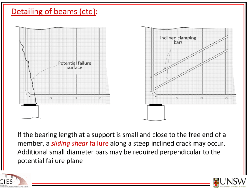

I think there is a potential failure mode here, as illustrated in this Gilbert slide. We also check large point loads adjacent to free edges (say when using a hydraulic jack on an abutment to lift a bridge).
Granted, the methodology to perform that check is up for debate (I'm actually in the middle of a claim over the issue). I'd love to hear how others approach it.

I would argue that failure you have shown is a result of lateral movement and the associated imposed loads. A different condition.
@Lomarandil I'm not entirely convinced that the sliding shear failure mode applies here (though I've never heard of it and it's good to learn something new; thanks). I'd have to read more about it, but on the surface, it seems like a non-negligible amount of beam axial load, lateral instability, or buckling of the column will cause that failure combined with the regular shear. This is also a weird little thing I thought about, but perhaps the miniscule curvature a beam experiences (like a 25mm deflection at midpoint) can impart some level of axial load, which can cause sliding for a heavily loaded beam with uneven loading. But it's a thought in my head and probably not anything real or quantifiable.
