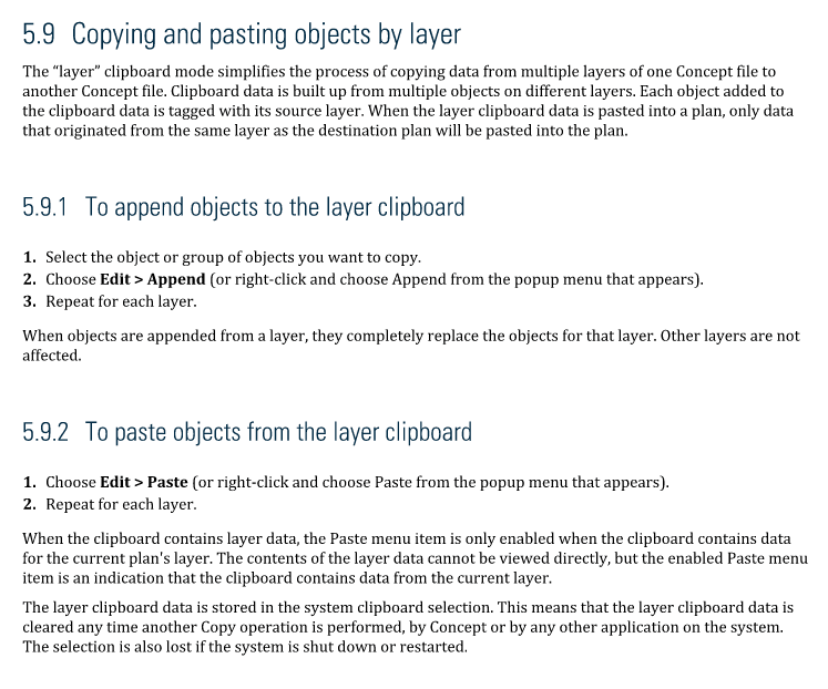

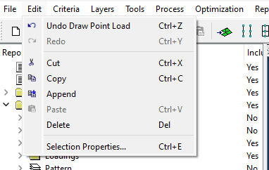

Can you share on "To append objects to the layer clipboard"? I don't see how that functions differently from the "copy"
Hmm - not sure what you mean. Can you show some screenshots?
This append tool
In what unique situation will append be advantageous?
Hm - not sure. Maybe post a question to the official Bentley forums, Seth is usually pretty responsive there
A bit more on the original topic of forked tendons: You can copy information from one Concept file to another, but a normal clipboard can only contain items from a single layer. It can be helpful to copy information from multiple layers at once. You can use copy append to create an super clipboard with data from multiple "layers", then paste the information into another Concept file layer by layer using the same clipboard. It does not save much time over multiple copies and pastes. Check manual section 5.9.
