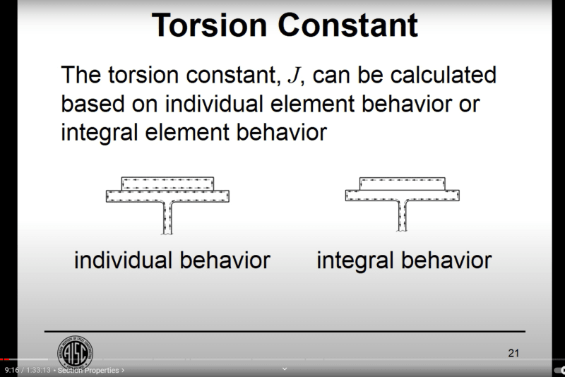

This AISC video gives a great explanation of integral behavior and individual behavior.
If you are using stitch welds it would be non-conservative to use the integral J.
In this case you want to use an effective J value, or conservatively use J individual.
This will make sense after you watch the video, skip to around 9 minutes into the video.
How would you go about finding an effecive J? Just weighting the J based on the combined J and individual summed J's at the stitch weld interval?
EngDM, I've never done it, I usually use the individual summed J's.
In the video I linked above, they provide a reference for calculating J with stitch welds and staggered stitch welds.

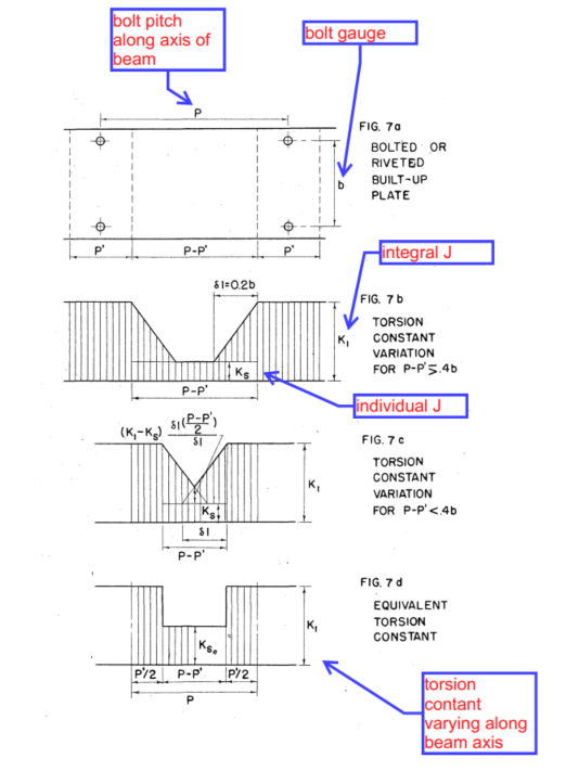

Kootk, I must admit I haven't read the reference "Torsion of Plate Girders (Chang and Johnston 1952) until now, as I usually calculate J using the individual behavior.
Your comments about the bolt gauge are valid, as shown in the photo below.
However, I believe the stich weld spacing or the rivet pitch (along the longitudinal axis of the beam) also effects the effective torsion constant of the beam.
I believe my comments earlier and the statements in the AISC video are valid.

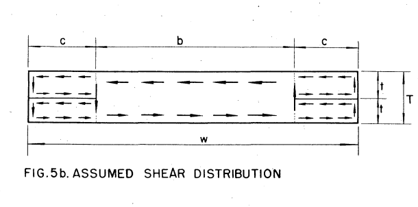

Consider the figures below, taken from Pg. 15 of the reference.
Kootk, any thoughts on my reply above?

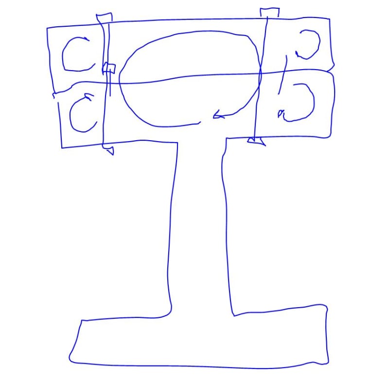

Thanks for the nudge, I've been meaning to return to this. I wanted to chase down another reference for you first but, seeing as that is holding up the show, I'll skip that and hope that I've earned your trust elsewhere somehow.
My thoughts are these:
1) My take on the section of the reference that you quoted is that its primary usefulness is in helping to inform designers on what an appropriate spacing for intermittent fasteners might be such that they don't have to worry about whether or not the integral J stuff has been compromised. As you can imagine, even 4W is going to be a very liberal stitch weld spacing in most flange plating applications where welds more like 2"@6" are the norm. That "notch of badness" in the reference sketches will quickly shrink into irrelevance at any practical stitch weld spacing I feel.
2) I feel that stitch weld applications wind up acting a bit like trusses from a stress field standpoint. The stresses tend to concentrate towards the welds and that is kosher so long as the angle of the faux truss webs don't get too aggressive. A 4W angled web would be very aggressive. A 1W web would be "normal" in the world of trusses and most weld patterns would go considerably lower than that. I've seen a highway girder publication where they studied the effect that lightly trussing a couple of deep highway girders has on the torsional stiffness of that system. It was a several thousand fold increase as I recall. I consider this to be meaningfully analogous to the situation that we're discussing here.
In summary, I stand by my previous assertions a) that no reduction need be taken for most practical situations and b) the guys in the video are out to lunch on this.

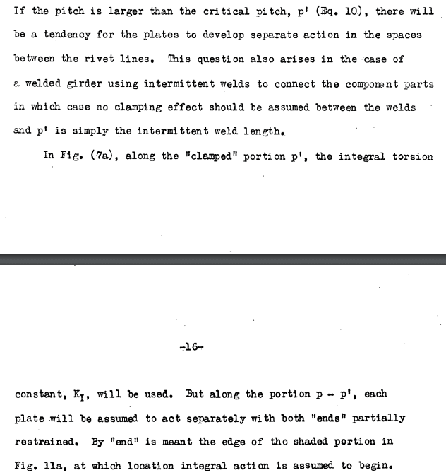

Just took another look at the paper, if your intermittent bolt spacing is less than P' you can count on the integral J without reduction. If your bolt spacing is greater than P', technically your J will be less than the integral J.
For bolted assemblies, P' = A*T, where A = dia. of bolt head and T = total thickness of plate assembly
For intermittent welding, P' = weld length
For assemblies that are stitch welded you cannot get the full benefit of the integral J.
I haven't gone through a calculation to determine how much of a reduction you get using a 3-12 stitch weld (for example), but the point is the J you should be using for design is still less than the theoretical integral J.
For practicality, I like to use the individual J - maybe that's overly conservative, I don't know.
