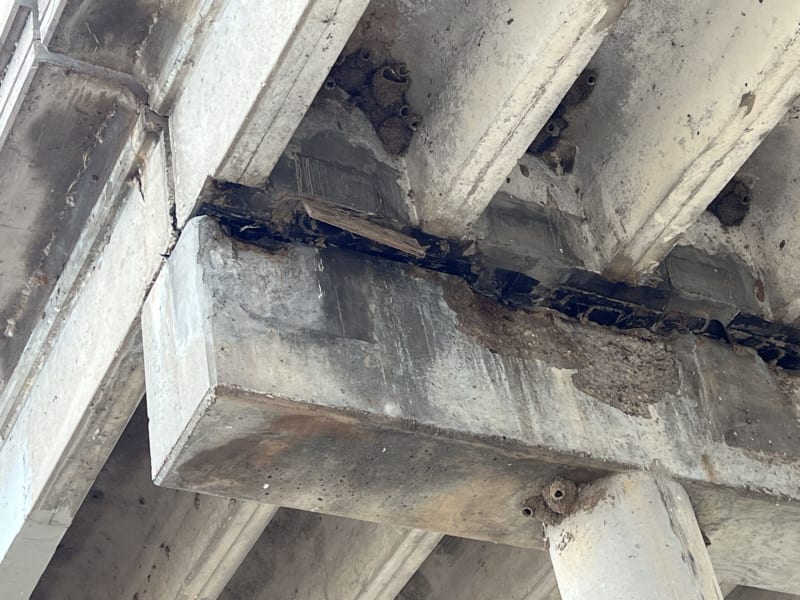

Here's another article on the matter:
Some pretty good pictures.
Odd that a passing fisherman was the one reporting the problem, instead of that bridge inspector. However, since it's "cosmetic", a little Bondo should clear it right. Since it's an emergency, we can skip the sanding part.
I do admit it to wondering how non-supported bridge shoes qualifies as "cosmetic". But I'm not in that trade, so.......

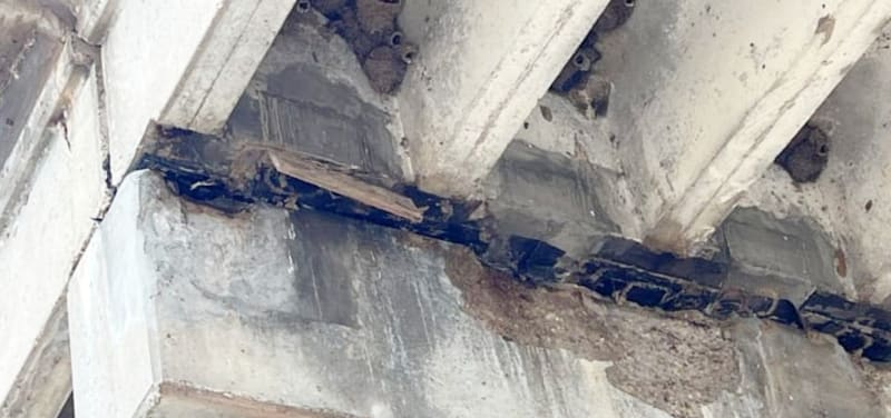

I doubt this is 4 months of deterioration, however the pictures (spsalso's link to the breckenridgetexan) have some clues. The different colors of concrete indicate there was extensive concrete repair performed here at some time in the past. It is possible that the repair concrete experienced rapid degradation such that it did not look as bad 4 months age, but was already barely hanging on. It should have flunked a hammer test.
This could be as simple as as incorrect mortar and detailing was chosen for a prior repair.
But, was it four months since it was inspected?
Is mortar appropriate for holding up bridge shoes?
If there was "...extensive concrete repair...", would that not signify a need to have intense inspection of the location until it was confirmed the repair was working? I look forward to reading the inspection reports.
Really? The areas in the photo looked perfectly fine 4 months ago? I will note an intense amount of weathering in the middle photo of the article. NO WAY that all happened in four months.

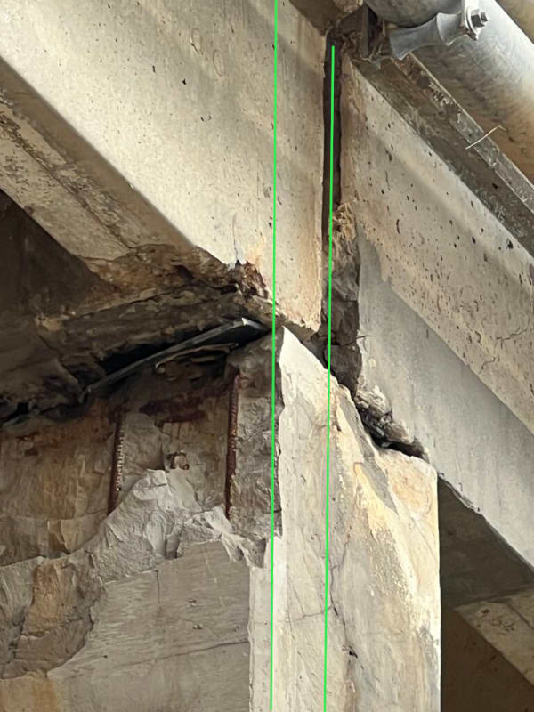

It appears the support has shifted ... a lot.
Ditto

Yes. And on the inspection date, the inspector gave the "substructure" a rating of 6. I expect that bridge shoes slipping off of piers would generate a far lower number (again, I'm not in the trade), so either the inspector did not see the problem, or the Bondo was still doing its job.
There are, by the way, quite a few piers crossing that body of water. We have only been rewarded with views of two (I believe). I wonder at the condition of all the others. And. If all the others are in really good condition, how is it that these two locations happened to have a dramatic failure. Especially considering that the construction method appears to be very repetitive? Why them?

From my post above, the piers are settling. From the images it looks as though they were wrestling with this problem already but it suddenly accelerated. That throws into question the thoroughness of previous evaluations.
Could it be that they lifted the T beams and reloaded the shifted piers thinking they could get away with it? Does the database indicate when this significant intervention took place?
IRstuff (Aerospace) - If looks like a variety of steel shoes on the diaphragm, a steel tab bolted under the diaphragm, and numerous shims, plastic or metal.
Edit: I might add, none of this seems to make much sense but we don't know what they were working with at the time.
