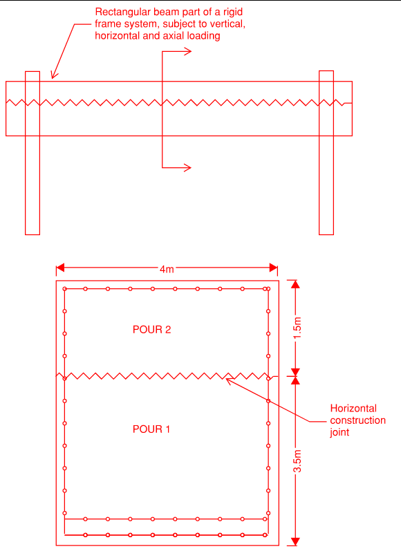

I have a large solid box reinforced concrete beam (h = 5m, b = 4m) with a horizontal construction joint 3.5m from the bottom. I am working with a spreadsheet previously set up by someone else that checked the situation referring to Eurocode 2, 6.2.4:

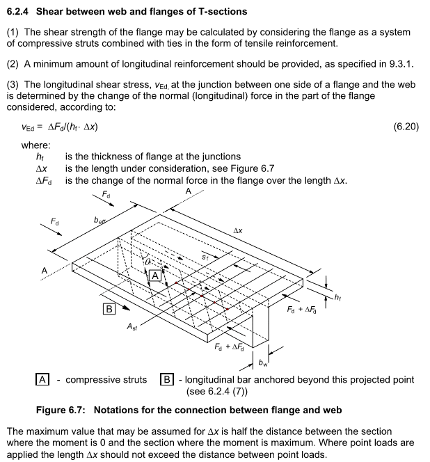

They calculated q = VQ/I, with V = vertical shear, Q = moment of area of the upper 1.5m of the beam, I = Gross moment of inertia of the full depth concrete beam. They then took vED = q/b to get the shear stress across the joint and compared that to the capacity of VRdi, which comes from 6.2.5:
My first issue is it doesn't seem to make sense to refer to 6.2.4 at all, and this whole thing would be most appropriately covered just following 6.2.5. Would be interested to hear any thoughts on that from those familiar with Eurocode.

I looked to this thread two times and still i am not sure i got your question.
Having worked with ECs in past , ( now i got retired for several years but responding to the threads just for sharing my experience) , my points ;
- Refer to BS EN 1992-2 clause SECTION 2 Basis of Design, All the clauses of EN 1992-1-1 apply,
- From 2-1-1 Tabel 3.1 obtain fctk, 0,05 for the concrete Strength class,
- Use expression 3.16 ( fctd = αct fctk,0,05 / γC) use the recommended value for αct = 1,0,
- The uncracked shear resistance is calculated with using expression 6.4 which is ,
VRd,c= (I*bw/S ) SQRT (fctd**2 +σcp*α1*fctd )
I hope my respond answers your question.

Appreciate the response. I apologize for a long winded question, I probably should have started with the basics. The sketches below hopefully make the situation more clear. I have no questions about the shear design of the beam, my question is just concerning horizontal interface shear across the horizontal construction joint.

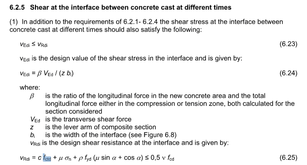

1. Should the capacity of this horizontal joint be taken as expression 6.25 (as copied in my first point)
2. What is the demand on this joint?
a. I know horizontal shear flow is definitely a component of demand. How is it calculated for a cracked concrete beam - with what moment of inertia?​
b. The beam also experiences axial force, transverse horizontal shear, and torsion. Should any or all of those factor into the demand?​
Australian not euro but have some answers. Use 6.2.5 with z lever arm for cracked section. You don't need Q & I to calc the stress. 6.2.4 is new to me. We just use our version of 6.2.5 with friction coefficients for monolithic pour when there's no cold joint. 6.2.4 and 6.2.5 seem disconnected because 6.2.4 is strut & tie with stress averaged but 6.2.5 is emoirical with peak stress used.
Do you have more reo than your sketch? Too far apart so ignore the reo because it's doing nothing for the stress in the middle. For axial and torsion you need to do first principles. Free body diagram of the left half above the joint. Needs to be half because the torsion will cancel on the right hand side so you miss the peak where torsion adds to shear stress. Axial won't increase the horiz shear if the force acts evenly on the cross section but would locally if it's concentrated and has to spread out.
I thought expression 6.24 as written is geared towards a vertical construction joint? How does vertical shear divided by vertical lever arm result in horizontal shear flow? It doesn't even account for where the construction joint is located in that case. Also not sure I really understand what the beta factor in that equation is.

This is just a rough sketch, the beam is heavily reinforced (3 rows x 27 Ø32mm bars on bottom and 2 rows on bottom, Ø32 bars spaced at 150mm along the sides, 6 legs Ø20 shear stirrups). Does that still seem like too little reinforcement to count on?
I follow what you're saying about torsion. For axial, the force can be introduced as a concentrated load at the top or bottom of the beam at the ends, so it does need to spread out.
Now, at the end of all this I will have two components of shear parallel to the construction joint (longitudinal shear flow and axial component) and two components perpendicular and coplanar with the construction joint (torsion and transverse horizontal shear). Would I just convert all these to stresses and add together, ensuring it is below the capacity of expression 6.25?

- Yes but this is ( 6.2.5 ) additional requirement to the requirements of 6.2.1- 6.2.4 . The capacity is calculated with the expression (6.25)
In this case you do not need to calculate the MOI.The design value of the shear stress in the interface is calculated with the expression (6.24) that is , vEdi = β VEd / (z bi). If the section experiences torsion, it will not be additive for shear at the horizontal interface between concrete cast at different times . If the section is box girder, the torsional shear and vertical shear can be summed for each wall.

HTURKAK, thanks for the response. Yes the section is a box section - I added a sketch to one of my previous posts.

"I thought expression 6.24 as written is geared towards a vertical construction joint?"
Can be either vert or horiz joint. Just use the shear in the right direction.
"How does vertical shear divided by vertical lever arm result in horizontal shear flow?"
See image. Moments about O at the reo give V * (delta L) = z * (delta C). dC/dL = shear flow = V/z.
" It doesn't even account for where the construction joint is located in that case. Also not sure I really understand what the beta factor in that equation is."
You actually answered your own question. Beta is when the joint is in the compression block. Say exactly halfway down the block then only half of (delta C) is above the joint so the shear flow on the joint is 0.5 * V/z. This is how we use this equation for the flange situation that eurocode uses 6.2.4 for. Use beta = flange area / total compression area.

I apologize, I realize I've been using confusing terminology. The section is a solid rectangle, not a hollow box.
