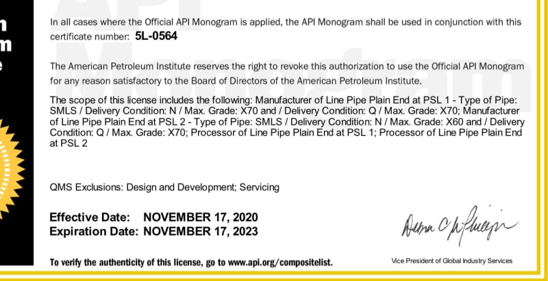

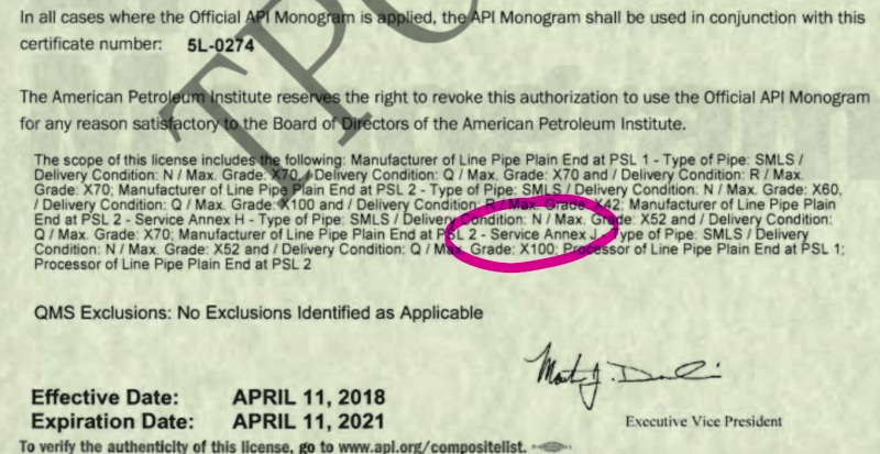

Dear SJones
Thank you for your reply
1. No - the API composite listing will be against API Spec 5L only; it will not single out Annex H(J)====>It appears that the API Auditor will be releasing the API MONOGRAM based on the mill capabilities outlined in the API 5L Specification. Please refer to the CERTIFICATE
for two different mills with varying scopes of acceptable products for API.
