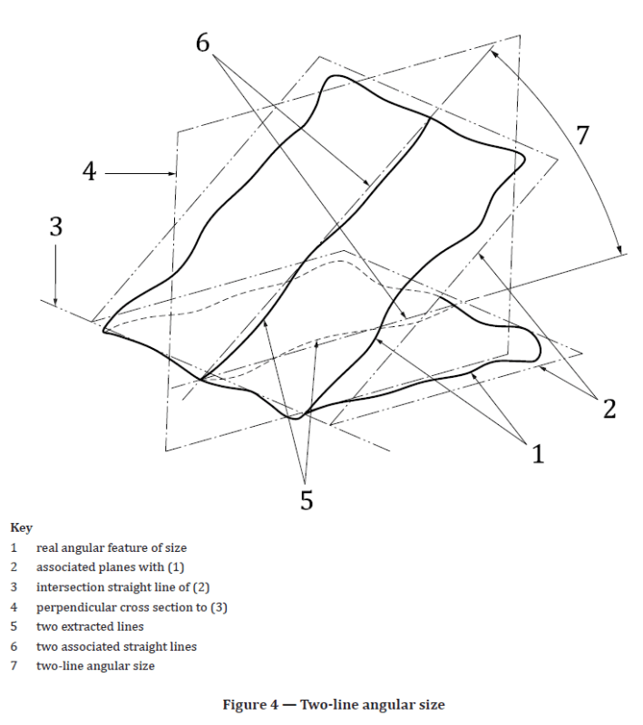

The rules of ISO 2768-1 are somewhat ambiguous. There's a whole standard on angular features of size - ISO 14405-3. From the section you've highlighted it seems like ISO 2768-1 is applying two-line angular size. Annex A of the standard provides more info this specific case. Unless they've invoked any ISO GPS standards (ISO 2768-1 is not one), then the definitions of ISO 14405-3 don't strictly apply but they can at least provide a guideline for you. In my opinion there's too much specification ambiguity in their drawing to resolve any edge cases. As is I'd consider 100% measurement on that drawing a waste because there's no defined rules. Perhaps you could talk to them about making a quality plan to work out the ground rules for what actually makes sense to measure for them to have an acceptable part.
