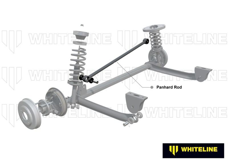

Are you sure that you've gotten the correct Panhard rod for your year and model?
Other flavors of Starlet seem to look like this:
Hi MintJulep,
Yes, it is actually that Whiteline product that you shown. The model number is KPR020 and they stated that it is applicable to P9 Starlet cars. Which include my EP91 model from 1997.
I've read on a Starlet forum how people who bought the KPR020 rod deal with having insufficient threads left to put the nut on. Some do weld the nut in the tightened position.
Well, I'm going to continue looking to make that shaft and weld it in a way without a brittle HAZ. That suggestion from TugboatEng to use 4130 steel seems to be a good one because it has lower carbon content.
