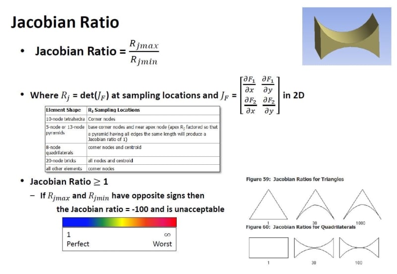

However, Ansys also uses Jacobian ratio >= 1. They define it this way (from the "ANSYS Meshing Advanced Techniques" presentation):
Here’s more detailed description from Ansys:
I’m not sure if it’s the same definition as in SW but it seems to be quite likely.

Regarding value range, I think SolidWorks define the ratio as |R[sub]j, min[/sub]| / |R[sub]j, max[/sub]|, which will limit the value to (0,1]

I think it’s the opposite. SolidWorks and Ansys don’t have the upper limit so they should be both using R_j, max / R_j, min right ?
