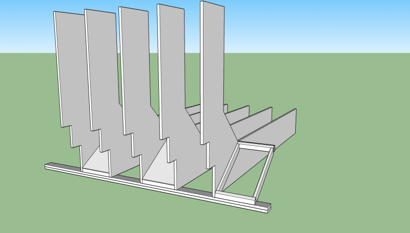

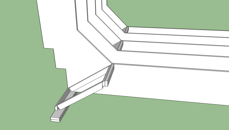

I gave this a bit more thought. I think I might do what Ron mentioned above and incorporate the parapet framing into the trusses. As you mentioned, that will cause the diaphragm sheathing to be held back to the parapet diagonal. To transfer the diaphragm shear into the shear wall below, I'd consider something like in the images below. Basically, 2x4s are sistered to the side of the trusses and are used to create a rectangular box between trusses which sheathing is attached to. Depending on your loads this might not need to occur between every truss, perhaps every other would work (as shown).
While this shear transfer mechanism will be some work for the framers and will require your oversight, in the balance of things, I think it's simpler than stick framing the parapet.
There should be continuous blocking supporting the edge of the roof diaphragm sheathing, which is not shown in the images above.
