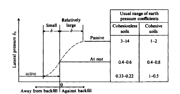

When checking the foundation for sliding under shear force, can I rely on both skin friction and passive resistance from the soil?
The case I have is a wind column footing which is burried in soil 42" (bottom of footing) for frost depth requirement. I do not see why passive pressure cannot be used. The dead weight from the column is negligible. If I just rely on friction for sliding resistance, the footing will be huge.

Based on that analogous situation, I think it would be reasonable to use the passive pressure against the side face of the footing, but subtract a distance equal to the height of the footing from the width of bottom face of the footing used for sliding resistance based on friction against the soil.
I typically throw a 100 psf passive resistance on footings for slide checks but that is it unless I am desperate. I figure that is somewhere between completely ignoring it and taking full advantage of it. Per the reasons stated above by MSL and Jerseyshore, I don't like to use the full soil wedge for passive resistance with footings, or on the toe side of the retaining wall.
In my opinion engagement of full passive pressure usually requires significant movement into the soil mass, movement would mean that static friction has been overcome so would not use full friction in tandem with full passive. I would try to use full friction in combination with at-rest pressure considering only the soil that I could confidently assume will exist at all times on the passive side.
@Celt83 Interesting, I never thought of using at-rest pressure in this way. It makes sense, because it doesn't need displacement to be engaged. But I'm wondering if it's truly applicable because it needs rigidity like a basement wall with zero displacement. I think a foundation would apply, because it's not like a retaining wall.
When significant movement is intolerable, I typically use friction and at-rest pressure (using Ko instead of Kp).

My read on this has always been that this is the case for at-rest pressure causing the de-stabilizing pressure, for engagement on the passive side of the wall the pressure begins at the at-rest pressure and builds up to the full passive value relative to the movement/rotation into the passive soil mass.
