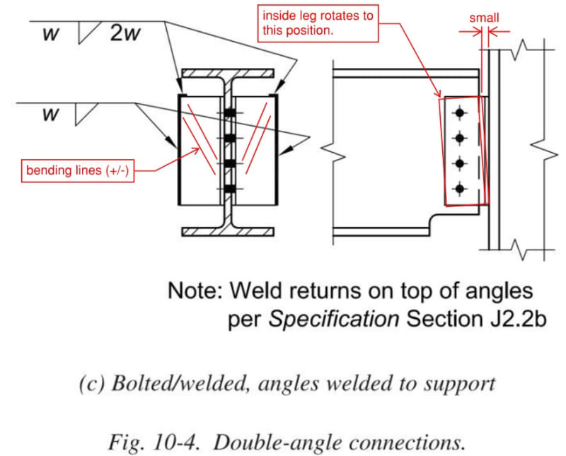

The shear connection will transfer some moment to the supporting concrete beams. If you're treating this as a shear (only) connection, then it should be designed to minimize this moment, though.
The following screenshot shows a common choice for this situation. Avoid welding across the tops of the angles. That way, the angle outstanding legs can bend out-of-plane a little and accommodate the simply-supported beam end rotation. The welds can be L-shaped with weld across the bottom of the angle if needed.

I use the same detail as 271828... and extent the weld across the bottom of the angle. I use a similar one if only a single angle connection. It allows a degree of rotation and is slightly less rigid. I review steel connections and have a '*.pdf' stamp to add to the drawings reviewed. Drawings I review usually have full weld on three edges.

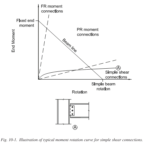

There will be some moment at this connection. It's hard to come up with a practical zero moment connection. We typically don't need to eliminate the moment, just reduce it to low values. In AISC that's called a Simple Shear Connection. The moment-rotation curve needs to look like:
Because the tops of the angles aren't welded to the support, the outstanding legs bend out-of-plane, allowing the tops of the angles to move a small distance away from the support. See below. The inside legs often have horizontal short slots, but that's now what we're counting on for rotational flexibility.

Well, most shear connections will have to transmit a small amount of moment into the connection. AISC has a whole concept (rotational ductility) that helps you determine whether your connection is flexible enough for you to design it as a pure shear connection. Refer to the following sections of the AISC manual (16th edition) for more information:
Double Angles: Page 10-9
End Plates: Page 10-22
Shear tabs: Page 10-49​

The double angle shown above is a good choice when it is important to minimize the moment.

...by having a weld length equal to twice the weld thickness at the leg of the angle at the top. This allows the angle to 'flex' between the beam web and the leg of the angle.
