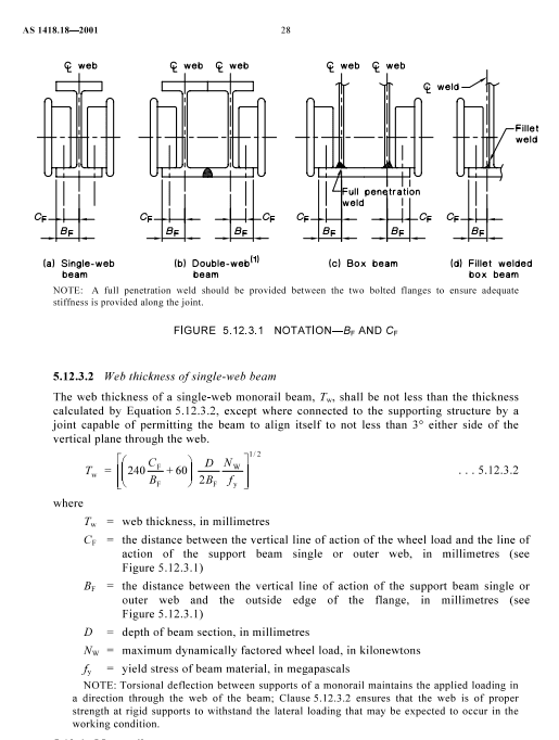

You can try your luck with AS codes and advice on flange design for monorails. I'm not sure if it is more or less conservative.
