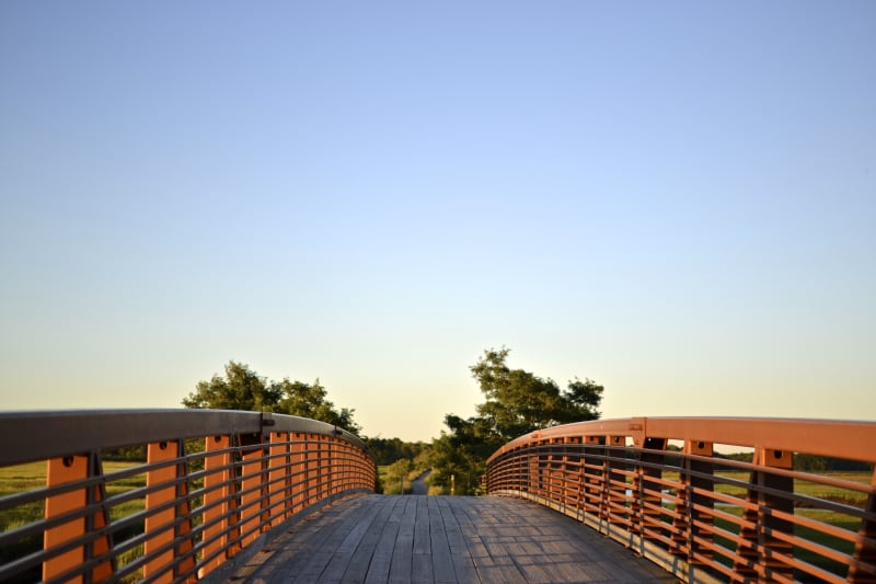

I live near this bridge, and I love it. Gives me joy to look at, even when I'm just driving by. Efficiency aside, something about the gentle curve makes it so much more aesthetically pleasing compared to flat chords.
