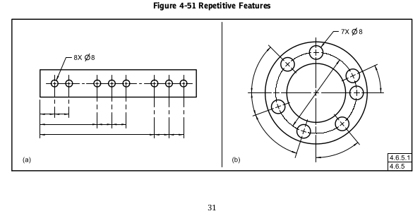

The closest that I had found is from ASM Y14.5 2018, pg 31 , fig 4-15.
In that figure with y axis is vertical, x axis is horizontal, the part's centerline and hole centers are coincident. Assume in my example that is not the case. Figure 4-15 doesn't address the case in my sketch and quantity callout convention. At a previous employer during a drawing review I made the double dimensioning mistake, but I can't recall what the checker cited, if it was an AMSE reference or what. It almost seems like it could have been a military reference...I just can't recall.
I'm now reviewing drawings, the double dimensioning similar to my initial post is commonly done, which I am attempting to end. But I want to reference a standard or good engineering practice, and not a "preference" if that makes sense.

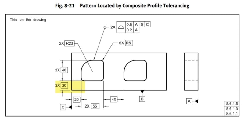

It's not fundamentally wrong to indicate the number of places that a location dimension takes place. Although The standard doesn't show that for true position dimensions for round holes, it does show it for true profile locating dimensions for irregular shaped holes.
This is from ASME Y14.5-2009:

I came across this a few minutes ago. It wasn't a hit when I initially searched. The difference being I've included the use of quantity and the common centerline.
