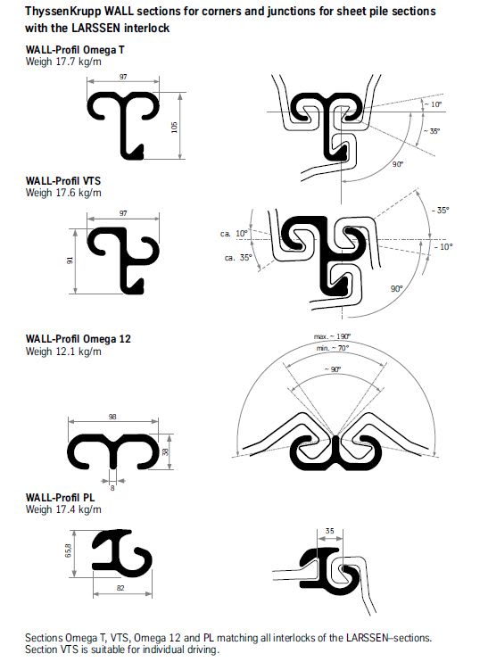

I've gotten deep in the weeds on Sheet Pile Connectors.
What is the difference between a "Larrsen" connection type and a "Larrsen-Omega?"
It looks like the Omega connectors are just a general purpose connector that will let you do a range of corner angles.
I want to make sure I'm understanding though.
Thank you,
Joel
Omega connections are used at junctions , corners etc and compatible to the Larssen connectors.
Pls look to the following book for more detail.

Larssen is a type of interlock found on hot-rolled AZ, NZ, and other brands of SSP. The other common type of interlock is the ball and socket interlock found on PZ and PZC SSP. The Omega is just a type or model of SSP corner that can provide certain turn angles for SSP walls. The Larssen and the ball and socket corners are not interchangeable.
