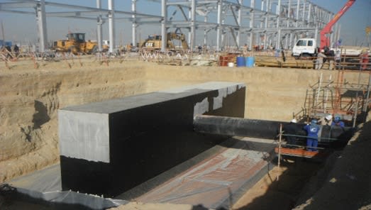

This is the F team.
Total waste of good concrete.
A gravity wave attractor (for powering gravity flow pipelines).
Assures that the outlet can never rise higher than the inlet?
Capping off the entrance to the Jinn's cave?
Proof that not all black holes are spheres?
A 500 tonne thermal anchor.
By someone who didn't believe in virtual anchors.
I used that picture for a presentation in Abu Dhabi on how to design virtual anchors, add flexibility and ... save $5,000,000.
Really nice pipe rack though.
