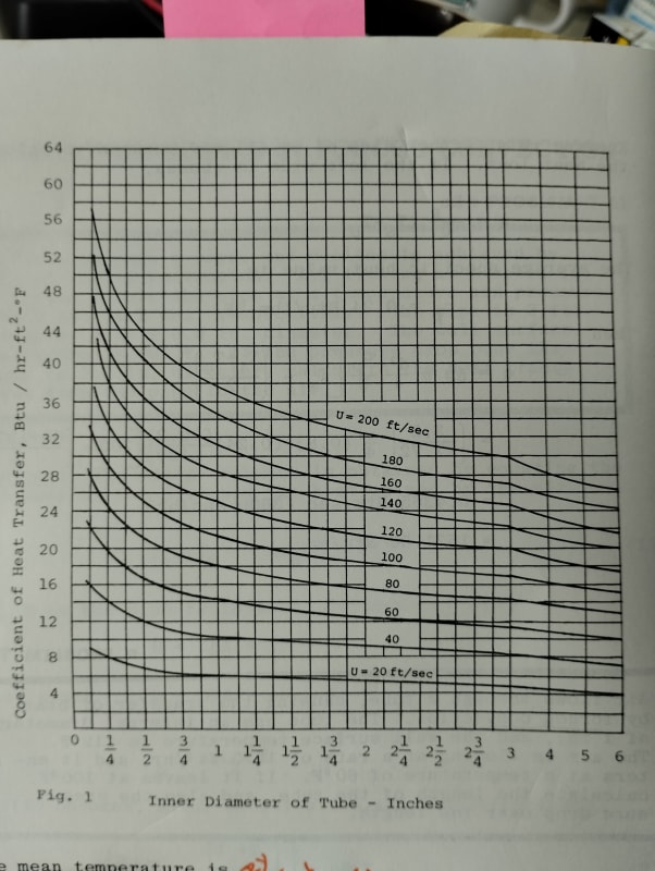

The attached figure may be of assistance.
The approach is designed for temperature change of water, but seems the equations should be valid for air flow, just use properties for air and correct units...

Finally found the easy way to do it buried deep in one of my thermo texts.
Simplified a bit by assuming that the pipe inner wall is what is being maintained at 45F.
I will try to check that solution (pulling the heat txf value from the chart) against some other specific formulas. In any case, your pipe length seems to be longer than you need to reach the 45° soil temperature and will probably have some safety factor in actually getting there. I solved for lengths of pipe needed to get to various temperatures up to 44.9°. You will see that you can never actually get there, just very, very close to it.
Hopefully someone will check the spreadsheet. I included pictures of the Example problem I followed, to make that as easy as possible. All feedback welcome.

"h" I'm assuming is Heat transfer coefficient of air? Your note says "h" is obtained from Figure1, but when I expand the pictures attached I can't quite see what's written on them.
[..... yes pulls the heat transfer coefficient =11 from the chart.
I'll take a better picture..]

Better picture? Just download it from this image or from the attached file.
Don't know why it's so dark. But it's readable.
Select your pipe diameter 4
Go up to hit the curve for your U = flow velocity 52
Now Left to get the h[sub]c[/sub] value. 11
Some of the simplifying assumptions
270 is a flow volume at the avg temp of Tm and atmospheric pressure, It may be at 70F, in which case actual flow velocity at low temperatures will be somewhat less. If 270 has a given reference temperature, T_ref, multiply 270 By (459+T_m)/(459 + T_ref) to correct it to the avg flow rate at T_m.
It is the pipe inside diameter surface that I assumed was kept at 45F.
The pipe insulation effect will reduce that a bit. I'll try to have a look at that.
I don't think it will be much of a reduction, but don't know for sure yet.
It might look tempting to use smaller pipe and get a high hc value, but your working pressure will increase. No free lunch. Need to keep as close to atmospheric pressure as possible, otherwise a lot of air property values, volumes and velocities will change..

That picture is much better. Thank you for replying to my questions, everything but point 6 is super clear now = )
