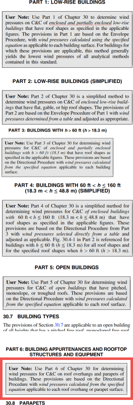

How does one design for components and cladding for a partially open building using ASCE 07-16 or 07-22? While I do see a definition for partially open buildings, and design for such for MWFRS, I don't see any design methods for CC.

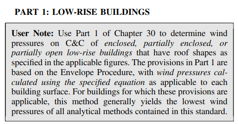

From 7-16, I don't see provision here for partially open. I do see the GCPI factors from Tab 26.13-1. Am I missing something from Chp 30?
In ASCE 7-22, partially open is included in those. My assumption is that they messed up and forgot to include it in ASCE 7-16.

smokiibear: Components and cladding shall be designed using Chapter 30 from ASCE 7-22 (OR ASCE 7-16). You first need to determine the velocity pressure as per Chapter 26 equations. Then, for cladding, determine the effective wind area. Then use the tables in Chapter 30 to get coefficients and finally use the equation 30.30-1 to calculate the pressure. Use +/-0.18 for partially open buildings as jdcollins suggested.

I was looking at ASCE 7-22 last night, and missed that Part 1 does cover partially open buildings. So, just as you both shared, that does work.
