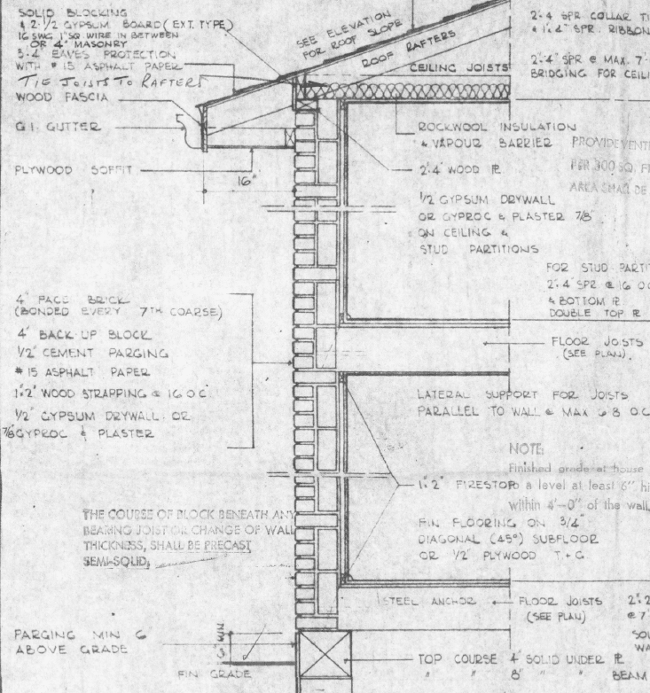

Not a lot of experience with older brick/block walls. Existing 2 storey 40+ yr old house all walls as 4" brick exterior with 4" block backup, with bond bricks turned every 7th course. I believe that this is considered as an 8" masonry bearing wall...not 4" load bearing block with 4" veneer. The building depts around are extremely quick to call out 'brick veneer' can't be used for connecting or supporting any load whatsoever, no matter how miniscule. I don't think I am off my rocker in coming back at them that this is NOT brick veneer, but in fact 8" solid masonry bearing wall. Opinions or experience with this? Thx.
Can you provide a sketch? I want to make sure I've interpreted this correctly
Do you have brick stuck directly against masonry block?
Is there any reinforcement in anything?
I only have this from existing house plans.
Neat, that's a very helpful sketch

If your beam or whatever can reliably socket into the wall onto both wythes I would consider it as an 8" wall
If it's just landing on the masonry block side then I would be a bit more hesitant
I guess the turned bricks will give you some composite action but I'm just not a fan of bricks over blocks!

If it was double brick I would definitely be taking it as an 8" width with the 7th course transverse blocks, so taking off my conservative hat, it seems appropriate to do the same here

Looks like the roof rafters land onto the top of the brick coursing. Not a veneer in my opinion.
Adding a 2nd storey over the garage portion which is currently 1 storey. And upping the height of that existing garage wall from 8' to 11'...that's where I started worrying about width of wall for the slenderness check of t>h/20. Clearly single wythe wouldn't cut it, or even work for existing 8' height for that matter.
RPGs...that is my thinking as well. However I will likely end up with a few significant point loads here and there from beams that I may ask them to slot in a steel post for, especially if they land near existing openings. And sides of existing garage door I don't like the idea of large concentrated loads either that could end up loading one wythe more than the other, so I'm thinking steel posts there as well slotted into the block wythe.
