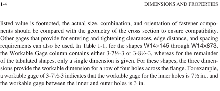

workable gauge disambiguation AISC
struct_eeyore
Feb 21, 2017
251
Looking at the workable gauge for a W14x193 in the AISC manual, we're given 3-(7-1/2)-3. How is that to be interpreted? Is it 7-1/2 with +/- 3" in ea. direction? Thanks!
The following from the AISC Manual Part 1, Page 1-4, explains this.
