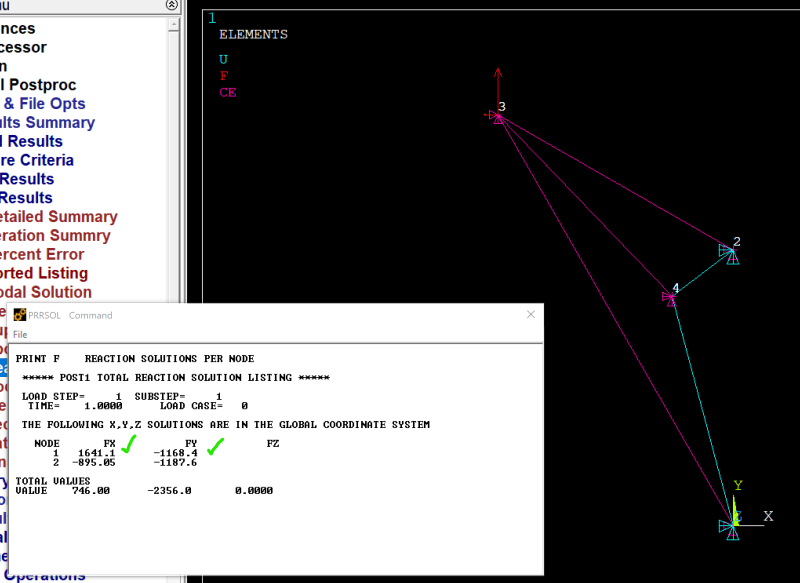

I am undergoing through a situation similar to the one discussed in thread2-478490. As hand calc results I obtained for a typical shear joint with eccentric loading cannot be recreated using non-rigid bodies in mechanical, I am now trying to follow the approach proposed in such thread. However, I have been unsuccessful since I cannot figure out how to create the RBE3 constrain equations with the RBE3 command. I get a warning saying the RBE3 command is ignored since the dependent nodes 1 & 2 are colinear, which seems to be true and also a requirement for the RBE3 command to work.
Also, even though the reactions from the apdl model satisfy equilibrium, the vertical reactions are dissimilar and inconsistent with the hand calc results based on equal distribution of the vertical load Fy for rigid bodies.
Is there a way you can think to built the constrain equations using RBE3 command for this specific geometry? My hope is that using RBE3 constrains, the vertical load will be distributed equally at the nodes 1 & 2 displacement BC's.

Hi SWComposites. So I revised the code and worked around the RBE3 requirement in ansys by adding an additional node #4 to break colinearity and got closer to the handbook solution. As expected that got me the a better load distribution among the two reaction points node 1 and node 2, where both are now reacting in the same direction. I can fine tune the location of node #4 to improve the correlation but it feels like an empirical thing to do, so I am not totally convinced I am doing this right.
The model is made of truss elements link180, connected thru nodes. RBE3 constrains were made between master node #3 and nodes #'s 1,2 & 4.
Think I am missing something?
