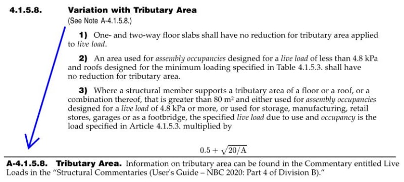

office 1.9kPa
Storage 4.8kPa but the NBCC has a clause - 4.1.5.8 Variation with Tributary Area which allows for a factor to decrease load on storage buildings based on the area. Live load resulted in 3.6kPa. So the live load increased but did not quite double.
Dead load remained at 1.8kpa
So the total load went from 3.7kPa to 5.4kPa: a 50% increase in total load

I'm not too familiar with the NBCC, but it doesn't seem logical to me that they would permit a 25% live load reduction for a floor joist subject to storage loading. Maybe for a column trib area, but for a joist or beam it seems really unconservative.
Agree with Bones regarding live load reduction. For 4.8 kPa areas it's a minimum of 80 square meters before it kicks in.
Also, storage loads are often non-reducible
Below is the clause and a reference from the clause. As I read it, this OWSJ is a "structural member supporting a tributary area of a floor."
Bones206, I wonder if you would be correct in interpreting only columns as being a "structural member supporting a tributary area of a floor."
The floor plate is 320 sq ft per floor.
The area used in that calculation is per joist, not the entire floor plate. Therefore for an assumed spacing of these joists of 6 feet (1.8m), they'd need to be 146 feet (44m) long. And that's just to get to the 80 square metres. To get a LLR = 0.75, you'd need to get to 320 square metres of area per joist.
Great point jayrod12, not how I had read it.
When it comes to a load bearing wall, column or footing, I wonder if then you would use the area of the floorplate which is more likely to add up to a number higher than 80m2.
You'd use the tributary area associated to that specific item under design. If you're designing your wall on a per metre basis, then getting to 80 is tough if it only supports one or two floors. Beams and columns you get to 80 far faster. Columns you're there right away with a 9m x 9m grid.
I think the wording is quite clear and jayrod12 is correct. Your joist in question is a structural element that supports a tributary area which is NOT the entire floor.
