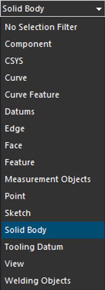

Hello everyone,
I'd like to introduce my latest creation: Captain Hook's Component Creator. Infused with a touch of nautical flair, this tool is designed to streamline the process of component creation within Siemens NX, locally and when integrated with Teamcenter environments.
Under the Hood:
- Local: The tool searches for the first sequential component labeled "-101". It then generates the next available component number. These components aren't saved; they are created for you to save if you are satisfied with the outcome. The journal searches through your library, session, and memory for the component name you have set, checking for available or missing numbers to avoid duplication. The names for the components will be derived from the names of the solid bodies. If a solid body does not have an assigned name, the default name “Panel” will be used.
- Teamcenter: The tool employs a two-round approach to ensure each component is sequentially numbered and accurately tracked in Teamcenter. You can use both the first and second rounds or only the second, depending on your requirements.
Round One: Sets and saves an initial ID number, anchoring the starting point for a sequence.
Round Two: Uses a substitute wildcard number to generate subsequent IDs, which requires experimenting with formats like "*" (star).
Features:
- Smart Sorting: Utilizes EasyWeight or NX's built-in material attributes to sort solid bodies by material name and weight in descending order or retains the order of your initial selection.
- Unit Support: Adapts to both metric (millimeters) and imperial (inches) units within material names.
- EasyWeight Integration: Updates all weight information before component creation with automatic recognition of the unit system.
- Configuration Settings with detailed descriptions at the beginning of the Journal: WaveLink options, flagging created components to avoid duplication, controlling numbering gaps for local environment and Teamcenter option.
This tool is ideal for mechanical engineers and designers using Siemens NX who require an automated method to create components in complex assemblies, particularly beneficial in large-scale projects.
The journal has been thoroughly tested on Siemens NX 2212 and 2306 and is designed for easy customization to fit specific project requirements. For more detailed examples and configuration settings see comments at the beginning of the journal.

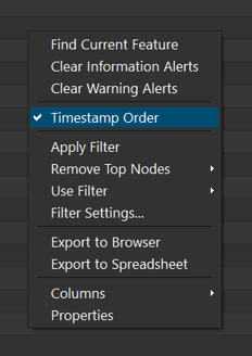

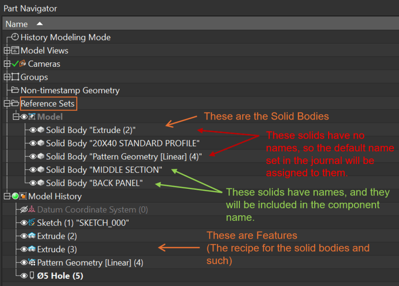

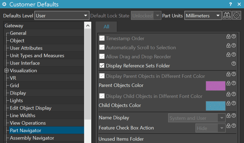

	' Default Solid Body Name - Assigns a name to any solid body that lacks one, ensuring all bodies are identifiable.
	' You can set these names under Reference Sets.
	' If you can't see this folder, click on a empty space in Part Navigator / uncheck Timestamp Order OR File / Utilities / Customer Defaults / Gateway / Part Navigator / Display Reference Sets Folder.
	Dim defaultsolidbodyname As String = "PANEL"

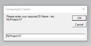

	' If you are using this locally, you will be prompted at the beginning to specify where you want to save your files. If you leave it empty and hit enter, it will use the specified default directory (lldefaultdirectoryPath).
	Dim teamcenterIntegrationQST As String = "False"

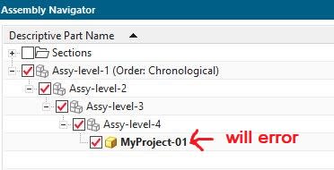

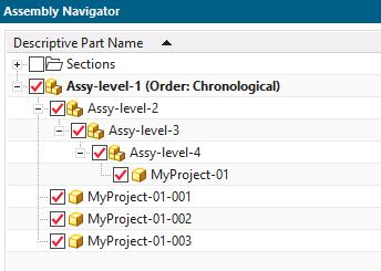

	' Control Numbering Gaps - Only for Local - This feature enables intelligent handling of component numbering. For instance, if you initially create components numbered 101, 102, 103, 104, and 105, but later delete 101 and 103, activating this option will prioritize filling these gaps with new components before proceeding to increment the numbers. It's an efficient method to maintain a continuous sequence and optimize the utilization of available numbers.
	' Remember, when removing components, it's important not only to remove them from the assembly but also to close them using File / Close / Selected Parts. This ensures they are removed from memory as well.
	' Additionally, if you are working locally and have saved these parts, you should also delete them from the file system to avoid clutter. - True or False
	Dim fillTheGap As Boolean = True
	' IMPORTANT! Record a Journal first in - Visual Basic (*.vb) - by Developer / Record with Assemblies / New Component. Complete the entire process of creating a new component, then stop the recording. In your saved file, you'll find the following variants (note that prefixes such as 'tc', 'll', and 'wl' won't be included) - the matching words are highlighted:
	' partOperationCreateBuilder1.DEFAULTDESTINATIONFOLDER, fileNew1.TEMPLATEFILENAME, fileNew1.UNITS, fileNew1.RELATIONTYPE, fileNew1.TEMPLATEPRESENTATIONNAME and fileNew1.ITEMTYPE.
	' Copy paste the values.

To name the solid bodies, follow these steps:
[ul]
[li]Navigate to: Part Navigator / Reference Sets / Model / Solid bodies[/li]
[li]You can rename the solid bodies here by slowly double-clicking on them.[/li]
[/ul]
[ul]
[li]To modify the default solid body name, locate this line in the journal:[/li]
[/ul]
Code:
If you don't see the Reference Sets folder, go to:
[ul]
[li]Customer Defaults / Gateway / Part Navigator / Display Reference Sets Folder[/li]

If you can't enable the Reference Sets folder:
[ul]
[li]Right-click in an empty area within the Part Navigator[/li]
[li]Deselect 'Timestamp Order' from the menu[/li]
[li]This action will make the Reference Sets folder visible, allowing you to name the solid bodies.[/li]

If you want to handle them in the graphics window:
[ul]
[li]Set your Selection / Type filter (selection scope) to Solid Body[/li]
[li]Select the solid body / bodies you want to rename[/li]
[li]Right-click on one of the selected bodies[/li]
[li]Navigate to Properties / General / Name[/li]
[li]Enter your desired name[/li]
[/ul]

I just ran thru this tutorial, on a test assembly, I'd already created with your journals, and when I added names to the bodies, IT EVEN updates, RIGHT THRU the assembly, this is GREAT stuff..
This journal is great, but to suit my needs, i'd like to modify it a bit.
I changed the line you suggested (in the Component Creator) and I can now select any bodies in the assembly levels below the top level work part, and it adds the new parts at the bottom
, then i can drag them under the correct part ALL the while keeping the links intact (brilliant)
..I wonder... is it possible to modify it, to work if I'm work part at a lower level, because up to now it'll error if you're not right at the top of the assembly.

Dim assemblyid As String = InputBox("Please enter your required ID Name - etc. MyProject-01", "Component Creator")

Yes, I have forgotten! Do the following as an addition to the previous changes - locate these lines in the journal and delete them:
In the Main Sub, after the setcomponentflag check (V109 Native - Line 276, V111 TC - Line 353):
If String.IsNullOrEmpty(selectedObjectName) Then
Continue For
End If
And in the SelectObjects Function (V109 Native - Line 533, V111 TC - Line 1113):
If String.IsNullOrEmpty(item.Name) Then
item.SetName(defaultsolidbodyname)
End If
