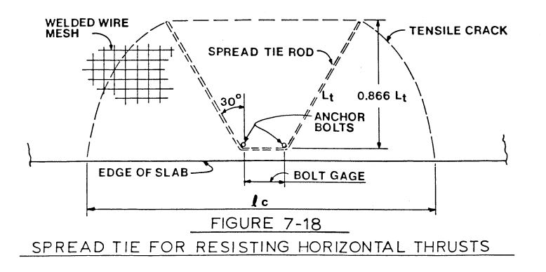

Could you theoretically have slab leave-outs (for future plumbing) in the yellow highlighted areas of the foundation plan?
Assume that you do not have columns creating thrust in the north-south direction.
If you have more area of steel than the 2 hairpin in that region would say yes?
As I understand it, those hairpins get the load into the slab.
Where does your load go after that? Do you have enough "white" concrete slab that you don't need the yellow concrete slab?
Jersey, you consider all your resistance to the lateral load to be within that zone?
I`d typically argue that the hairpins transfer the load to the slab reinforcing (mesh in your snip), and the important area is much larger than your sketch shows.
Yes the mesh or reinf is essential to the design of hairpins. Sorry I didn't realize OP was talking about physically leaving sections of the slab open. Was thinking more about joints. Not sure why you'd only pour half a slab. If you are going to leave strips of concrete slab in place it's probably better to just design straight tie rods.
I've done a bunch of these, and a lot of it comes down to the function of the slab. If you have wire mesh, you're likely designing a slab on grade with control joints. Typical practice is to discontinue or cut every other wire across those joints to allow the slab to crack properly. Based on the aspect ratio of your slab joints, do you have enough concrete to resolve the thrust into the slab, and drag it out via gravity/friction?
If you have a heavy industrial slab that functions as a structural slab or mat foundation, chances are you might have deformed bars to which you may be able to quantify a much larger chunk of concrete.

Hair pins are good for preventing shear blowout of the anchors, but not much more. Transferring thrust from hairpin to slab reinforcing is really hard and I've only gotten it to work on really small buildings.
I've never used or seen anything other than hairpins designed to resist the thrust on PEMB's, even moderately sized ones. Sometimes the lengths are long and slabs/ reinf get thick, but it's definitely the preferred method around here.
Agree with phamENG. IMHO, hairpins are not appropriate for resisting thrust. A cheap and nasty solution to a difficult problem.

StrEng007 - I agree, they are an option. I just don't find them to be a very good one. But they time you account for the angle, lapping the bars, reinforcing the slab as a structural element (something not often done as they just use 1.4 or 2.0 WWR to limit crack widths), I found that it uses way more steel than just running 4 tension bars straight across the building below the slab. That way, you have a 12x12 tension tie and the rest of the slab can be left out for pluming rough ins by future tenants.

Yes, I think so. I have an old Butler manual that talks about hairpins. But it wasn't intended for anchor breakout, but for resisting global thrust at the column base.
