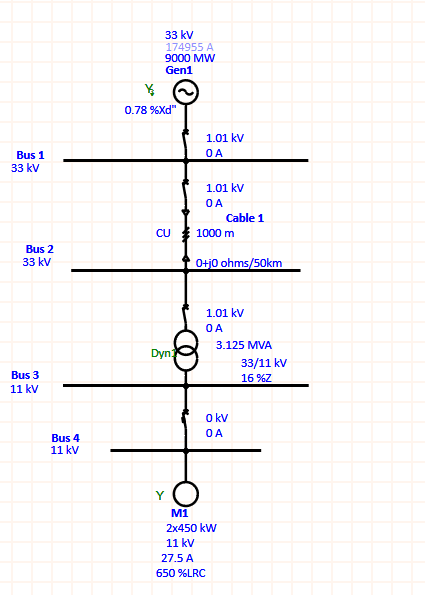

hello everyone,
Please I have been getting this error message on ETAP, can anyone help me out with it? how do I resolve this?
Error 2000: (Substation) Number of energized buses is less than two.
Error 2001: (Substation) The system has no swing power grid or generators.
Error 2002: (Substation) The system has no energized branches, such as cables lines and impedances, e.t.c
Never used ETAP, but that seems pretty straight forward; the model is too incomplete to solve.

The messages are self explaining, you can’t perform SC or LF study without basic configuration:
Swing node (grid), buses and branch energised.
this looks complete to me
If you have already undergone a formal ETAP training then you would have got answers by yourself like running a LOADFLOW without a swing bus which is very basic.
Otherwise if you have a valid license you have to contact ETAP HELP by sending your project to ETAP help.
They are very prompt and helpful
I don't use ETAP. However, what do you need in order to solve the problem in simple excel is the same.
As I understand you need to state the type and size of the connection cables.
So, you have to chose the cable type -at least the standard [for instance BS 6622 or IEC 60502-2 or UL 1072 or else].
Then you have to chose the conductor [cu or al].
And then, how you state to run the cable-direct underground, in duct bank and so on.
You have to state what is the required load on each bus.
Even, you know all the power available from both generators you didn't state what is the power evacuated from each bus bar.
Ok, the diagram seems complete but:
Did you configure the generator as swing node?
Thanks for the help guys, I later found out I didn`t set up some parameters which I later did and it worked
