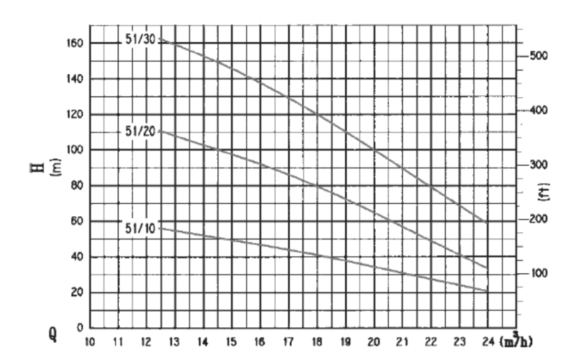

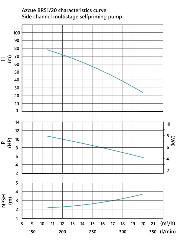

This is the original pump curve:

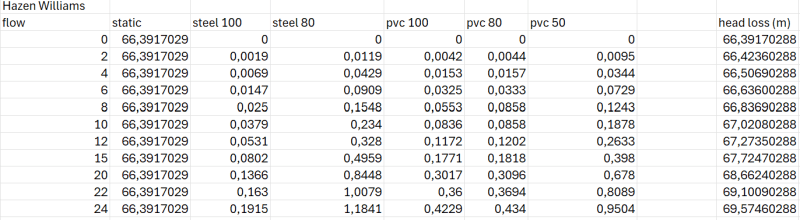

For the frictional losses, I have measured and collected all the fittings that are in the system, and used this site/calculator: I took the Head friction loss from the Hazen Williams Equation as this was the most conservative. This head loss is the plotted system curve in my original post.

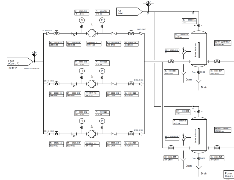

PI&D drawing of the system:
If it would be possible, I would want to keep the pumps, but with a frequency drive that can keep up with the live consumption/pressure drop in the vessel and that stops when there is no flow. This would prevent high pressure shocks in the PVC system which often causes pinholes and leaks, and the very often starting and stopping of the pumps (around 300 times a day). These pumps might not be suitable for this solution, but no is also an answer on the research question, where I can offer alternatives.

Actually what are you controlling on? The P&ID doesn't seem to have any instruments(!) So how does it turn on and off.

I have attached a datasheet of the pump that is used. The specific type is the BR51/20.
The air in the vessel is constant. The pressure vessel is filled with a specific amount of air, which does not change. This is only filled when the pressure has severely dropped or when maintenance on the vessel has been done. Currently, the two vessels are both in use in parallel, meaning that 1 pump fills both vessels and they are both emptied by water consumption on board.
There is a big difference visible when running on one or two vessels. When one vessel is in use, the pumps start roughly 500 times a day with an average running time of 45 seconds. When two vessels are in use, the pumps start around 300 times a day with an average running time of 90 seconds.
The thing I want to know is why my system curve is that far of the current operating point of the pump. As I've mentioned in my first post, I measured the flow of the pump at around 11 m3/h during a filling cycle while the cross point of my calculated system curve and the pump curve this should be around 19 m3/h.

There may be some errors in the pressure drop calcs, assuming your fill rate of 11m3/hr is correct.

The pump curve you posted on 11 May 01.10 is for the 50Htz, 1500 rpm machine. You tell us you have 440V 60 htz, presumably 3 phase. At you quoted amps of 28.7, this is a power into the motor of about 18.5kW. Shaft power is probably about 17kW. The size 51/20 curve show this to be about 10 or 11 m3/ hr and off the left hand side of the curve, so not really a good idea, but equates to your measured flow.
The discrepancy now is that this would be at a discharge pressure of about 12 bar. So somewhere between the pump and the tank there is an additional pressure drop. You need to physically check the entire pipe run to see if someone has inserted a control valve OR some one in trying to reduce the number of starts has throttled one of the isolation valves to slow everything down. Ask the operators what they've done, but they might lie to you so go check yourself.

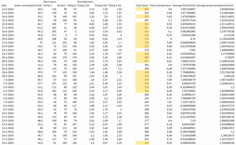

It has been some time, have been busy with normal work. I've had some time to do some more measurements on the system.
Took a clamp meter to measure the current of the electromotor, measuring around 15 amps.
I also timed a pump run (exactly 1 minute) and measured the height the vessels increased in volume, making it possible to calculate the pump flow (one minute, 9 cm increase -> vessel inner diameter of 98.8 cm gives a volume of 0.07 m3 for each vessel -> 0.14 m3 in one minute, gives 8.4 m3/h).
Also keeping track of the running hours and starts of the pump, see below screenshot.
Marked in yellow are the values above average. 25-4-2024 has a peak amount of starts, this was due to maintenance on one of the hydrophore vessels, making the system run on 1 vessel.

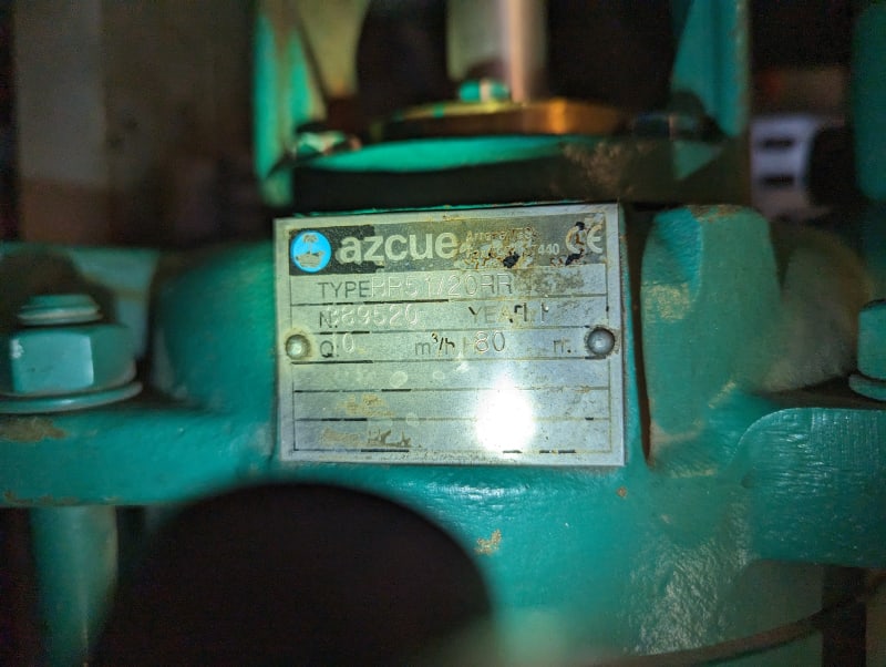

Then I had a quick look on the pump info plate and got very confused.
(Picture is rotated 90 degrees clockwise)
This plate mentions a Q of 10 m3/h with an 80 meters head, while all documents on board and found online mention an 18 m3/h at 80 meters head? Type BR51/20RR, running at 60 Hz.
[URL unfurl="true"]https://www.castlepumps.com/images/uploads/datasheets/BR_Datasheet_compressed.pdf[/url]
This could explain the offset of my pump curve and system curve, because I am now doubting the pump curve that is used in all documents.
Would love to hear your opinion on this.

Nameplate with equal measured values evidence cannot be denied.
The answer was hiding in plain sight.
Mystery solved.
Yes, but name plate doesn't state rpm...
If the pump has been combined with 60Htz supply and motor it will do more. You need to double check the frequency of the supply.
Also you need to include the outflow which might be occurring at the same time.
45m3 over say a 16 hour average is 2.5m3/hr so you pump is probably doing much closer to your 10m3/hr.
But you key issue remains- far to many starts so you either need to adjust the start stop pressure range or have more storage or run the pumps continuously but with a low flow bypass or install a smaller pump to operate unless you really need more flow than your average flow of about 2.5 m3/hr. IMHO.
Also the power at 15 A 440V is about 9 to 10kW shaft power.
That equates to your 50 htz machine at about 9 to 10m3/hr.
Everything is telling me that pump is working at 50Htz somehow. Maybe there is a frequency convertor on that set of pumps??

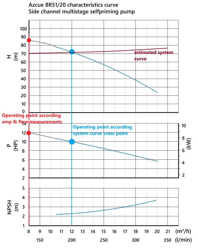

I redid some drawings and calculations and results are below.
With the measured amperage and flow at an average 7 bars, the working point of the pump is left of the curve at 8 m3/h with 85 m head and 9 kW (~14A). It is inline with the curve, but it is just very low and out of the working limits of the pump.
With the calculated system curve and estimated pump curve in excel, I get a working point of about 12 m3/h at an average of 7 bars. This is on curve, but definitely not what the pump is operating at. I checked the whole piping system etc, but there is no extra throttling or other pressure increasing parts that have not been included in the system curve calculations.
See drawing below. I extended the power and head lines a bit with grey color for estimations.
How is it possible that the pump is operating that low and of the curve? What are the effects on the pump?

Only thing we haven't talked about for some reason is what is the actual diameter of the impellor?
Or these are multi stage pumps? ( the second number appears to be the number of stages) So maybe you've actually only got 15 stages and 5 dummy stages? Or just 15 stages. Have you counted them?
Have you tried the original vendor and asked them the details suing the pump serial number? The name plate tells you something is not standard here.
It does say in their blurb that each pump is "manufactured to order". SO the curves are really just generic and they mess about with the pumps to suit what each party wants. Someone clearly didn't want to have more than 8 bar a the design flow so that's what they gave you.
Oh and I don't understand your curves above. So e.g. at 12m3/hr with 20 stages, the pump is putting out about 110m, not the 70 you're showing in the curve.
If your curve is the one that came with the pump then it proves my point - the pump you have is different to the max 20 stage pump.
This is the 51/20 @ 1760 rpm from the vendor.
If what you mean is what happens leading to the left hand of the curve, its greenbelt not good, but can work for a long time. You are generally quite inefficient and the pump tends to have more recirculation within each impellor leading to excess wear.
However the vendor gave it to you at the rated flow of 10m3/hr so they must be happy with it.
