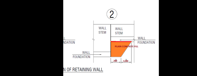

Pease refer to the attached sketch.
I have retaining walls at different levels as shown in option "1" in the attachment. I don't want to transfer the pressure of the upper wall to the lower wall and keeping in view the constructability constraints, I can't go for option 1. In option 2 the bulky part of concrete to reach the desired level of foundation seems too inappropriate for such a small retaining wall. Also I am unable to find any source to determine the dimensions I mentioned with question mark in option 2. I need your opinions on how to deal with this situation.

Consider the following dimensions . The higher level found. will be constructed first.
EDIT : You may use blinding conc. for plain concrete fill. ( Lean conc. (1.4.8 is OK)

@Hturkak I would like to know what factors/criteria to consider to proportion such shapes? We usually have to deal with such foundation shapes in other structures too, but all I have seen is "practices" being followed. Can I use lean concrete (1:4:8) here?
@dflva that could be an option too, but still I would need some reference for proportioning.

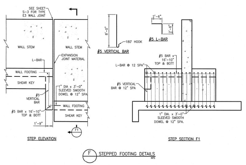

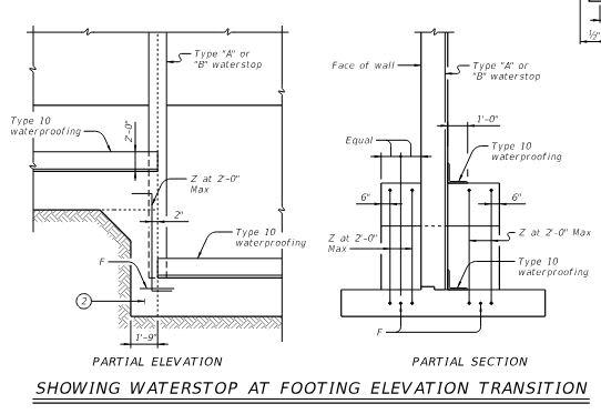

TxDOT has a detail for a retaining wall step that they have used for at least 10 years. It super simple. They just use a "Z-Bar"
I'm comfortable using this detail for a for a 3ft elevation difference.
I would not be surprised if the other big states DOT's have a similar detail. Check California and Florida.

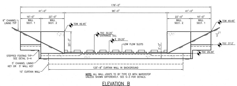

Here's a step that I did a few years ago. I used the TxDOT detail as my starting point. I decided to put an expansion joint right at the step so that if the walls wanted to move a little bit independently, then they could. (My elevation change was 8ft)
