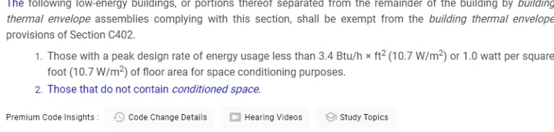

I'm trying to permit a small storage shed (12ft x 52ft, Occupancy S, Construction Type IV) not an occupied space, and need to address energy code. How do I work through this within the energy code? I don't see that it addresses unconditioned spaces.

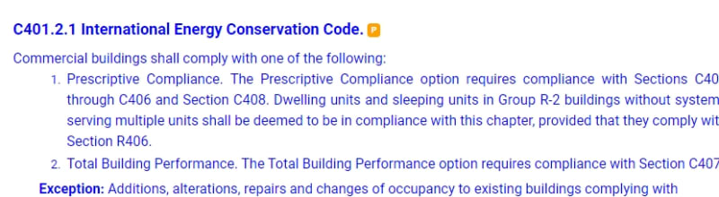

So C402-406, C408 or C407
C402.1.1
That gets you out of the envelope requirements.
I do not know your ventilation and lighting requirements, but you would need to work through sections C403-C405
C406 is where you get your credits. You should be able to get 9 fairly easy if you work through C405 for lighting.
