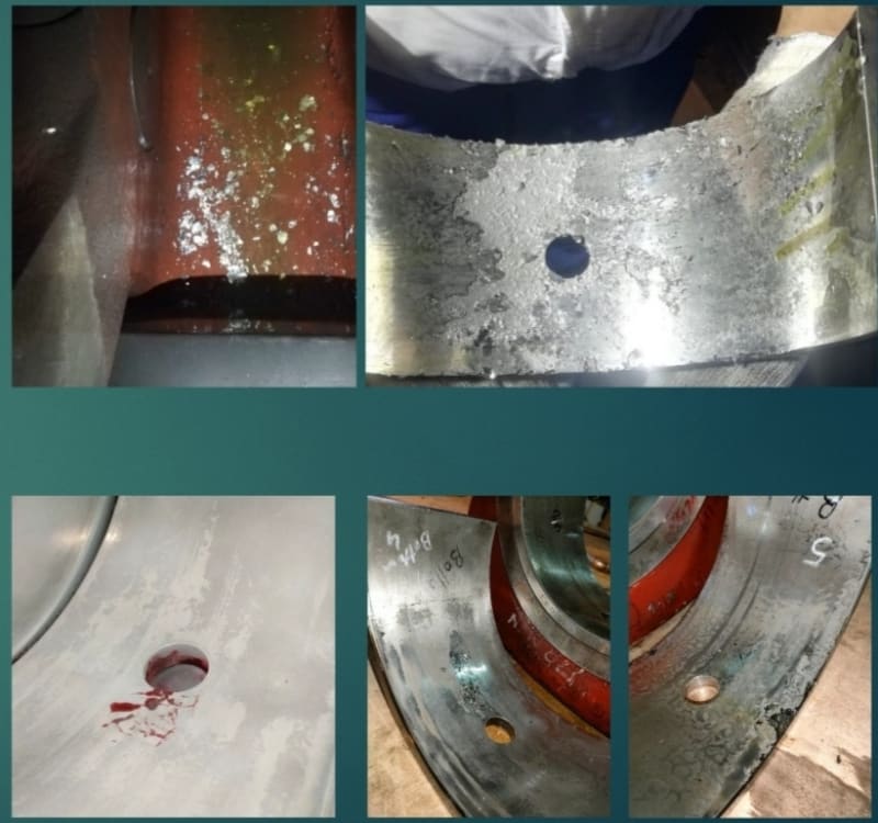

Reference this thread, now we have faced 8th big end bearing failure.
Can anyone provide details how Cavitation can be verified if there is any. As the other two pumps has same parameter but failure is being observed only in one
Also comment on the Babbitt of the bearings. Previous or old se bearings have ASTM Babbitt Grade 2 while new bearings which are failing have Babbitt Grade 3

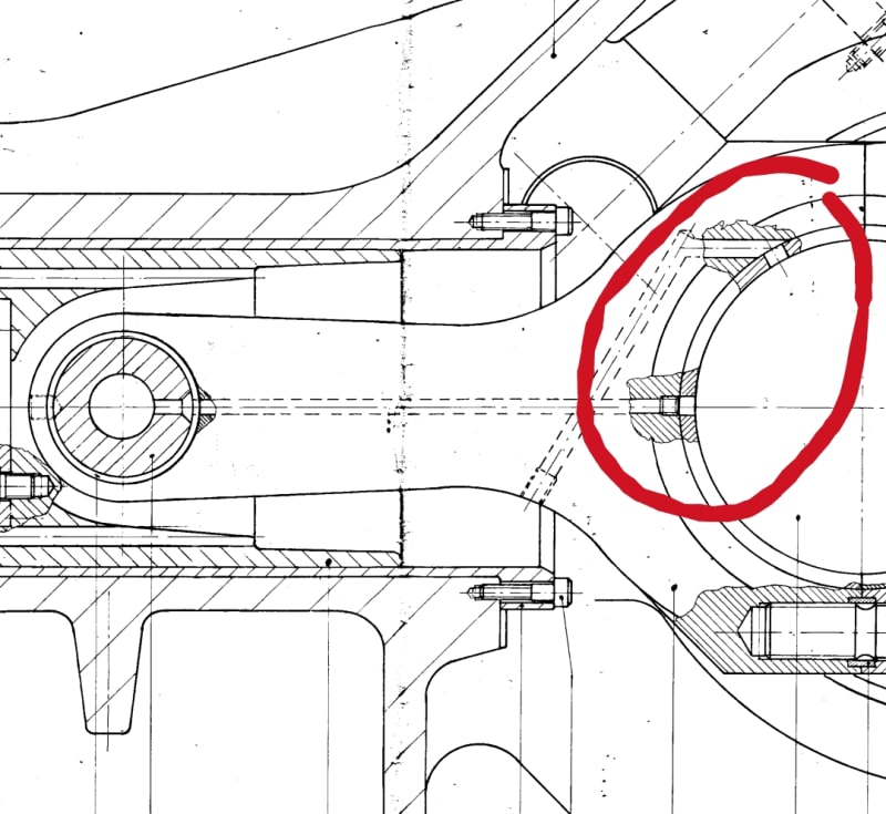

The Cavitation in reference is in the lubrication oil which is being provided to big end bearings of the crankshaft. It is a recip pump
The oil is fed from the lube oil pump to the small end.gudegeoj pin has a hole which aligns with the hole in connecting rod through which oil is supplied to big end bearings. It is quite opposite to normal recip machines.
Big end bearings are being damaged
The pump is a quintuplex pump having crankshaft with 6 main bearings (sleeve type) and 5 main bearings (sleeve type) lubricated by a lube oil pump.

It is made difficult when pictures of the broken part are shown and no pictures of any of the other parts that could be doing the breaking. "Attached is the picture of lube oil path" was exciting until I saw it was another picture of the broken part and not a diagram from the pump, the oil galleries, any pressure regulator, or any other things that are supposed to deliver the oil to that bearing.

Sorry for the broken part picture. Now attached is the picture of oil passage.
The lube oil pump is gear type and is making enough pressure, we always check the lube oil path and flow before assembling the pump.

To show the previous linked image:

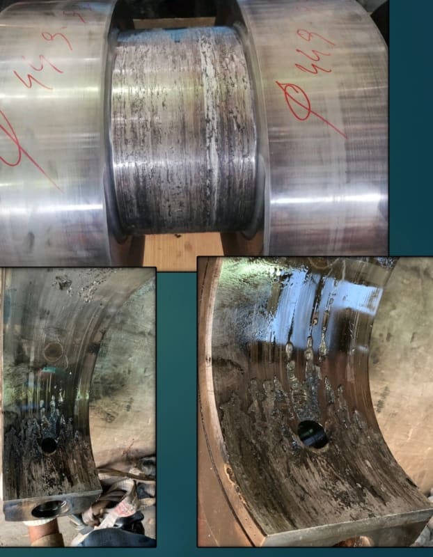

When 1st bearing got damaged. The white metal was seen to flow and melted. And this first damage consisted of Grade 2 Babbitt. The crankshaft got damaged also sowe have to replace the crankshaft with new one.
Afterwards when new bearings were used the OEM provided us with Grade 3 Babbitt and the failure mode shifted from melting to fatigue and chipping off the Babbitt white metal.
Till now we can't figure out the exact cause. And the difference of Babbitt was noticed yesterday. The failures are happening since 2021.
Also coming to ESD. As in Steam Turbines, ESD can develop due to blades coming in contact with droplets of moisture etc. can electrostatic build up be developed with oil as in crankcase 1/3 portion is filled with oil, and their might be relative motion of crankshaft with oil
You can clearly see the difference of damage mechanism
