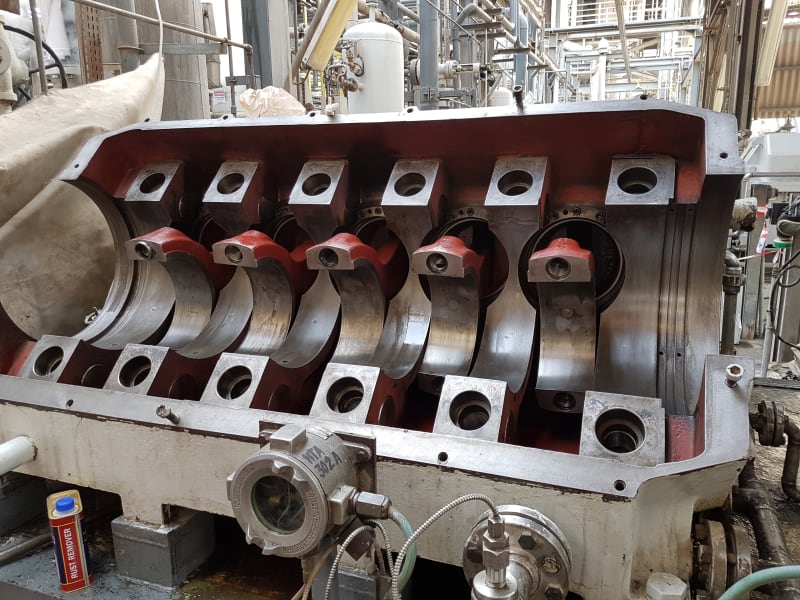

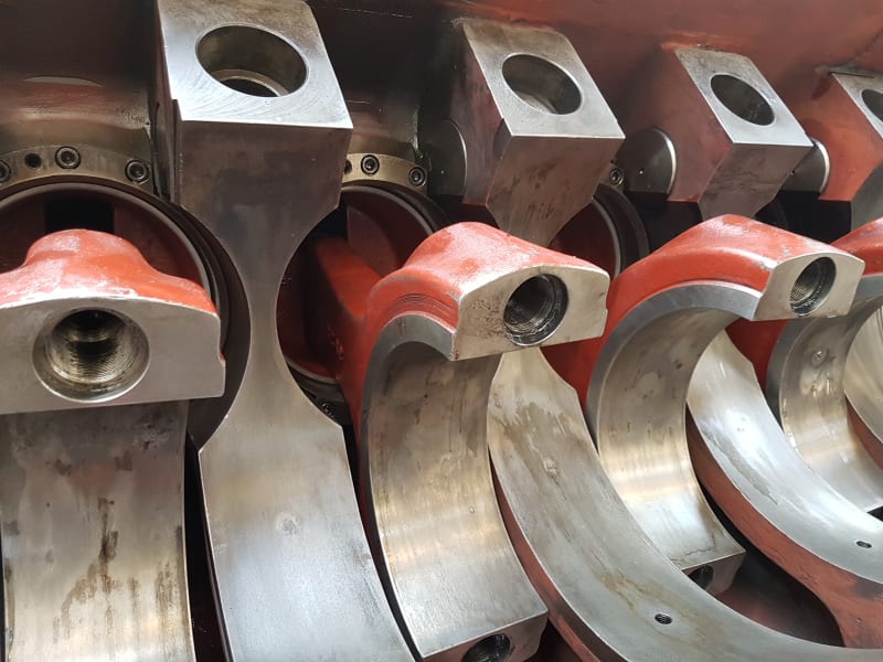

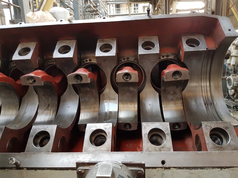

Reference this thread, now we have faced 8th big end bearing failure.
Can anyone provide details how Cavitation can be verified if there is any. As the other two pumps has same parameter but failure is being observed only in one
Also comment on the Babbitt of the bearings. Previous or old se bearings have ASTM Babbitt Grade 2 while new bearings which are failing have Babbitt Grade 3

I was having a conversation with a person on LinkedIn. I told him the clearances of the bearings.
Main Bearing Journal Shaft OD is 450 mm
Clearance is 0.36 - 0.60 OEM Recommended
Big End Bearing Journal OD is 255 mm
Clearance is 0.2 - 0.45 mm
The person told that this is excessive clearance the Recommended clearance should be in Range 0.8 -0.9 X Shaft OD/1000.
According to it the big end bearing max clearance allowed comes out to be 0.22 mm and we are operating it above this normal clearance is 0.3 mm of Big end bearing.
According to him this causes impacting on the bearing due to which bearing fails
Anyone like to add to this comment?
Replying to above question the lube oil pump temperature and pressure of all 3 pumps is same.
And all 3 pumps are in continuous operation and don't stop
Attached are the pictures showing main bearings and big end bearings arrangement
