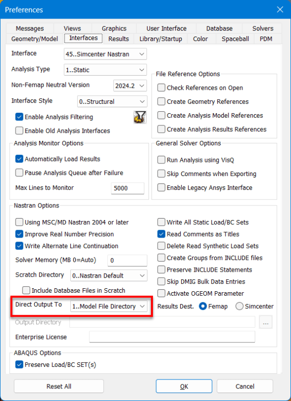

Never use the SCRATCH directory to save results, this is only for NASTRAN for temporal location during calculation, after solving with success NASTRAN will delete temporal results automatically.
Instead, use the local directory where you save the FEMAP *.modfem file.
In FILE > PREFERENCES > INTERFACES select the nastran option "DIRECT OUTPUT OPTION = MODEL FILE DIRECTORY", this way you will have all together the FEMAP *.modfem file and the nastran output results files *.dat, *.log, *.f06, *.f04 and the output binay results *.op2, ok?.
Remember to SAVE your FEMAP model before solving, this is critical, if not NASTRAN don't know where is the model file directory.

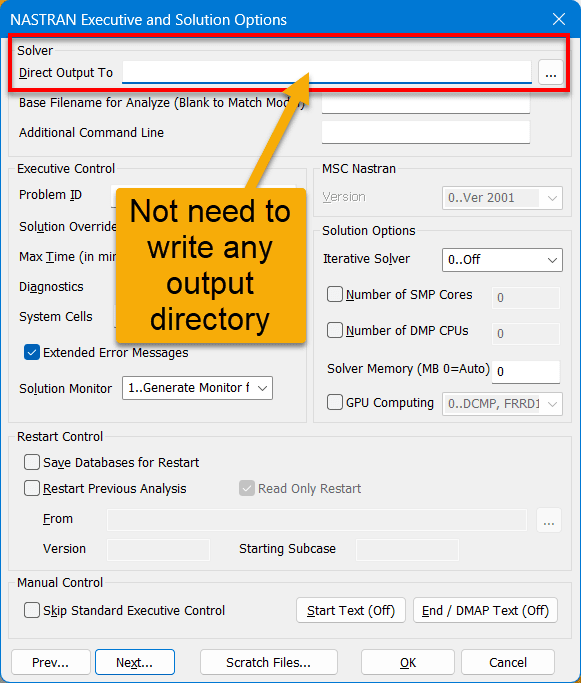

When you create an study not need to select any output directory, all NASTRAN files will be saved in the model file directory, automatically:

I have set up the Interface page the same as you suggest with no luck.

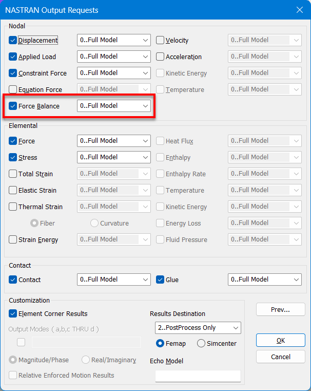

Dear Tom,
To help you more effectively you need to explain better the problem: How do you generate the EXCEL file, using an user API or a FEMAP command?.
When you say FORCE BALANCE you refer to create a FREE BODY DIAGRAM?. In this case you need to make sure to activate the FORCE BALANCE in the NASTRAN OUTOUT REQUEST
